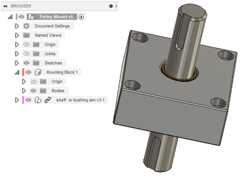

  6. Locate the desired file in the Data Panel, and insert it to an existing design. In the figure, the shaft w bushing component is an Inventor assembly file.
    Inserted AnyCAD file
