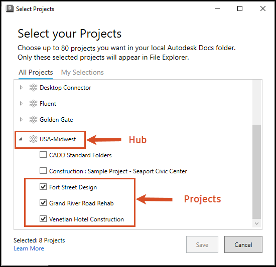

Why Select Projects?
When you first sign in to a version 16.x of Desktop Connector , you will be asked to make your initial project selection. This change was made to help speed up the process of accessing your data in Autodesk Docs. By adding only the projects you need, you can better manage your local storage space.
To select your projects, follow these steps:
  1. Click on a Hub to view the relevant projects.
  2. Select your Projects (you can select up to 80 projects).
  3. Click Desktop Connector Save button
    Desktop Connector Tray Icon
Note: In versions 15.x of Desktop Connector , all projects you have access to will automatically be added to your connector.

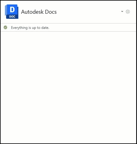

The home screen in Desktop Connector is the main display where all your connected drives are shown. It allows you to access multiple supported data sources (that is Docs, Fusion, and Drive). The Home Screen replaces the Pending Actions dialog of versions 15.x.
  • To switch between seeing different activity by connector, click on the header drop-down as shown in the following image.
    Home Screen Connectors

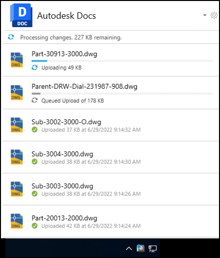

  • It is important to regularly check the home screen as it displays activities within Desktop Connector. Here, you can see the syncing status of projects, files, and folders. It is also where you can see more details about errors.
    Home Screen Activities

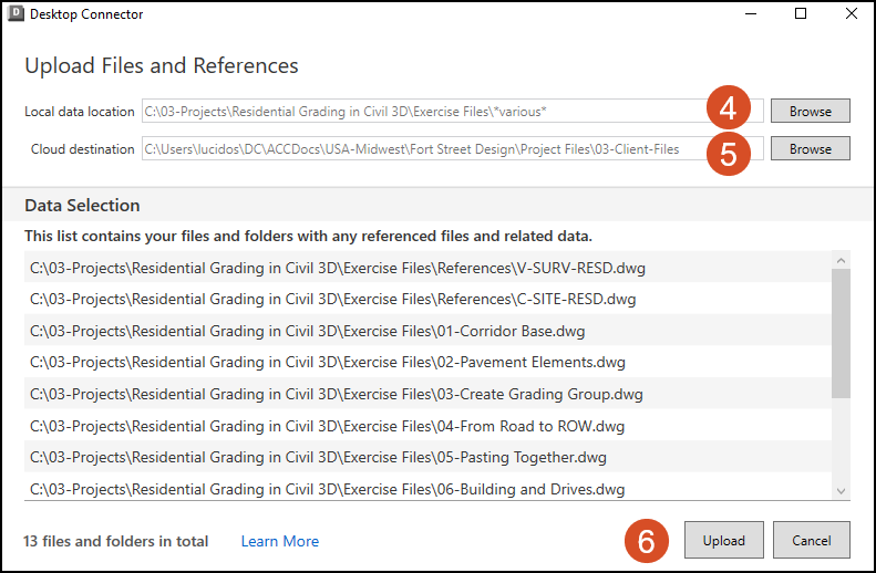

To help users who still want to upload files with references, we have introduced the Upload Files and References Tool. The Upload Files and References Tool enables you to add design files and view all their gathered references and related data before uploading to the cloud. Here is how to access it:
  1. Right-click the Desktop Connector tray icon Desktop Connector Tray Icon
  2. Click Upload Files and References in the menu.
  3. You can add files in the following objects:
    • An individual folder
    • Multiple folders
    • A combination of files and folders
    • A single file
    • Multiple files: You can only add multiple files from the same parent folder
  4. Browse to your local data location (Select all of the files you want to upload)
  5. Select your cloud location in Autodesk Docs

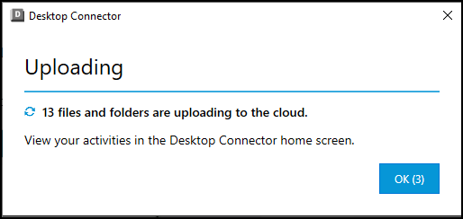

  6. Select Desktop Connector Tray Icon
    • Your files will now be uploaded to Desktop connector and synced to the cloud.
