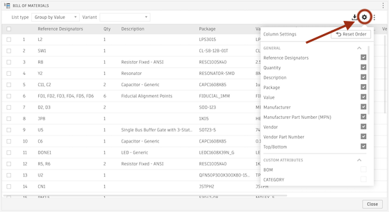

Select displayed columns
  1. In the Electronics workspace, open Bill of Materials BOM icon
  2. At the top right of the Bill of Materials, click Column Settings column settings icon
    bom columns
  3. Select or deselect the column names you want to show or hide
  4. (Optional) Select any custom attributes you defined for the open document
Change column order
  1. In the Bill of Materials, drag column headers left or right to change their order
