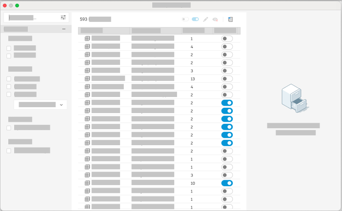

Library Manager
Figure 1: Library Manager showing available libraries
