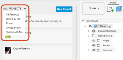

  3. At the top left of the Data Panel, from the drop-down menu, select the project filter you want to use; for example, All Projects.
    projects drop-down
  4. In the project list, double-click a project name.
