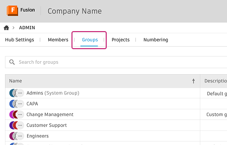

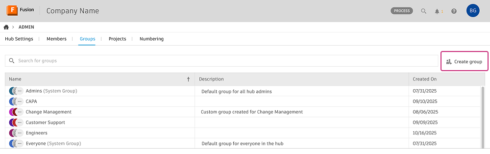

Hub admins can use groups to manage hub members and control their permissions. Instead of assigning access to each member individually, Hub admins can create groups and give them access to specific projects. This is useful when:
  • There is a set of members who share a specific responsibility or task.
  • You need to reduce the number of members to fit under the 500-member project maximum. A group counts as only one member, even if there are multiple individuals in that group.
All individuals in a group receive the same permissions for the group folder. However, these folder permissions are superseded if an individual has higher permissions in:
  • Another group in the folder
  • A parent folder
Requirements:
  • You must be a hub admin to create and manage a group.
  • You must use the Fusion web client to create and manage groups.
  • Groups within a hub must have unique names.
  • You can't nest a group inside another group.
  • You can't add inactive hub members to a group.
