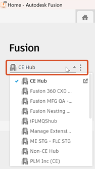

  • In Fusion Home, click the hub name on the left side of the window.
    home tab hub switcher

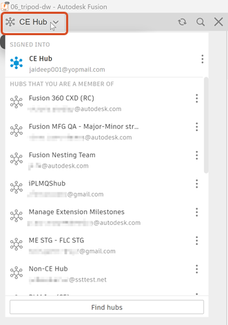

  • In the Data Panel, click the hub name at the top left side of the window.
    data panel hub switcher
    Tip: To open a hub in the Fusion web client from here, click More more menu icon beside the hub name and select Open in Web.

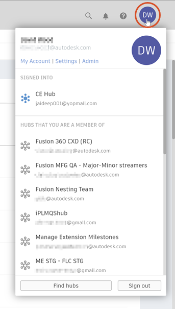

  • In the Fusion web client, click your profile in the upper right corner of the page.
    web client hub switcher
