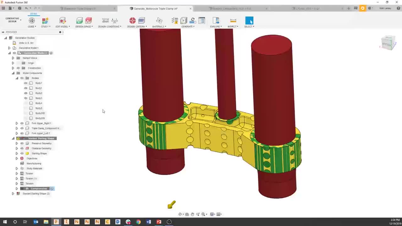

  1. On the Define tab, click Design Criteria > Manufacturing manufacturing icon.
    The Manufacturing dialog opens. By default, Unrestricted, Additive, and Milling methods are selected.
  2. Specify the manufacturing constrains for the following methods:
    • Unrestricted. Select this method if manufacturing constraints don't limit the shape generation.
    • Additive. Select this method and specify its constraints to generate outcomes which can be manufactured using the additive manufacturing process.
    • Milling. Select this method and specify its constraints to generate outcomes which can be subtractively manufactured using 2.5-, 3- or 5-axis milling operations.
      • Select the 2.5-axis, 3-axis, or 5-axis configuration from the drop-down menu and specify parameters.
      • To add a milling configuration, click add icon, and select a configuration from the drop-down menu.
      • To delete a milling configuration, select it on the list and click delete icon.
    • 2-axis Cutting. Select this method and specify its constraints to generate outcomes which can be manufactured using 2-axis cutting operations.
    • Casting. Select this method and specify its constraints to generate outcomes which can be manufactured using casting operations.
  3. Click OK.
    The dialog closes.
    Tip: To modify the specified manufacturing methods and constraints, mouse over the Manufacturing node in the browser, and then click edit browser icon.
