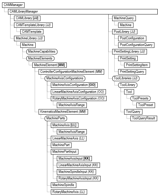

Another big difference between the library objects and the other CAM objects is they exist outside of Fusion documents. The CAM object is associated with a specific document and provides access to the CAM data that exists in that document. To provide access to library information outside the context of a document, the CAM API provides the CAMManager object which can be accessed directly at any time by using the static adsk.cam.CAMManager.get() method. The object model for the CAMManager object and the objects it provides access to are shown in the picture below.
CAMManager Object Model

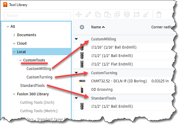

There are several locations where Fusion looks for libraries; Fusion Library, Vendor Libraries, Personal Libraries (both local and in the cloud), and the document library that exists within each document. Folders, and libraries are specified using a URL object. The URL is essentially a path to a folder or file that can exist locally or on the cloud. Let's look at a simple example to see what's available and what it does. Below shows the local location for tool libraries. It contains one library called "StandardTools" and a folder called "CustomTools" which contains two libraries; "CustomMilling" and "CustomTurning".
Library Example
Below is some example code that accesses the library using the knowledge about where it's located and then gets a specific tool from the library.
