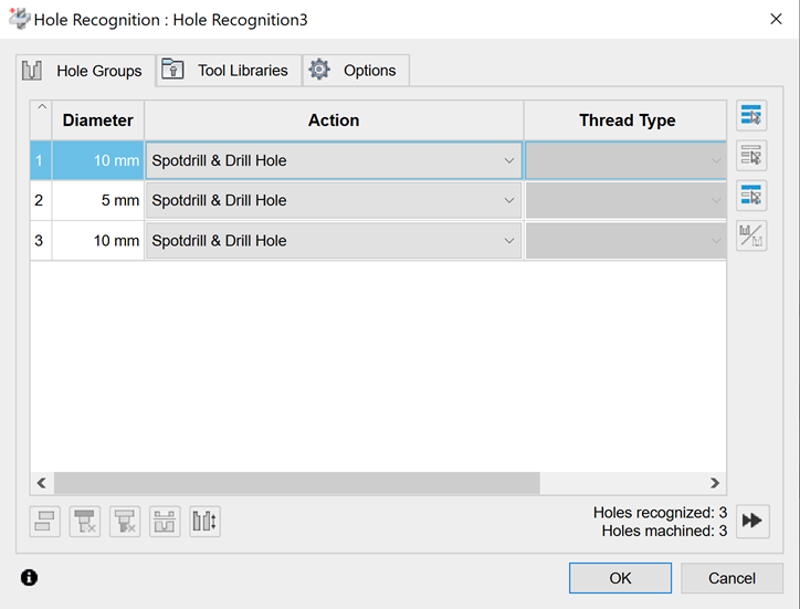

Hole Recognition
The hole recognition option available via the UI lists all recognized holes and hole groups based on the diameter and segment types. You can then apply a given template to the recognized holes or hole groups.
Using the API, you can recognize holes and hole groups using the adsk.cam.RecognizedHole.recognizeHoles(bodies) and adsk.cam.RecognizedHole.recognizeHoleGroups(bodies) methods. They both accept an array of bodies for the input and will return all holes for the body regardless or their orientation. Below is an example of a hole containing all possible segment types. Each segment can be a cylinder, flat face, cone, or torus. A hole signature is the list of segments that define that hole. Two holes are considered the same when they have the same number of segments in the same direction, and each segment must match the geometry of the other segment and have the same dimensions. The segments are in order from the top of the hole to the bottom. The difference between using the recognizeHoles and recognizeHoleGroups is the recongizeHoles method returns a flat list of all the recognized holes. Whereas the recognizeHoleGroups looks at the signatures of the holes found and combines the holes with the same signature into the same RecognizedHoleGroup.
