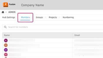

Access the Members tab
  1. Click your profile image in the top-right corner of the Fusion web client.
  2. Click Admin > Members.
    admin members tab

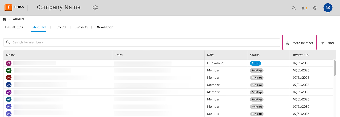

Invite members to a hub
  1. In the Members tab, click Invite member.
    invite member
  2. Enter one or more email addresses of the people you want to invite, separated by commas.
  3. Click Invite.
Invited members receive an email with a link to join the hub. Until they accept, they'll appear in the member list with the status Pending. You can resend or withdraw invitations from this list as needed.
