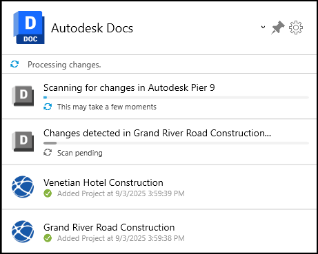

Autodesk Docs Home Screen
The Autodesk Docs home screen directly displays your activities from the previous 24 hours.
See Docs - Home Screen and Activities help topic for more information.

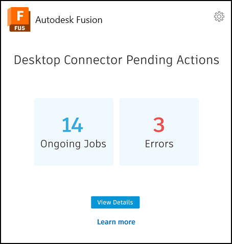

Fusion Home Screen
The Fusion home screen displays a total of:
- Ongoing activities which are currently processing
- Activities where an error has occurred
You can view any in progress activities by clicking View Details to access the Pending Actions screen.
See the Fusion - Home Screen and Pending Actions help topic for more information.

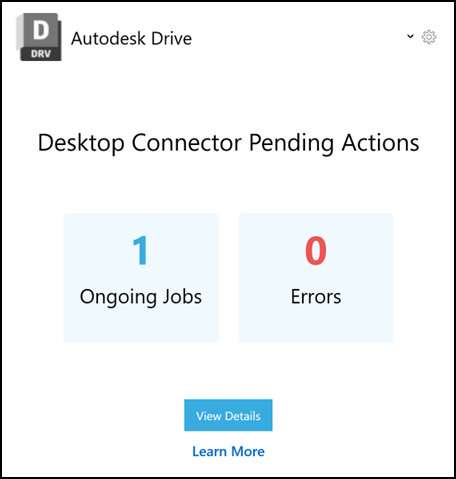

Drive Home Screen
The Drive home screen displays a total of:
You can view any in-progress activities by clicking View Details to access the Pending Actions screen.
See the Drive - Home Screen and Pending Actions help topic for more information.
