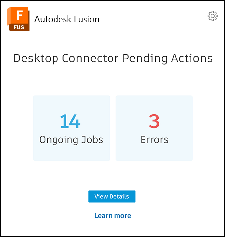

In the latest release of Desktop Connector, a new home screen displays your Desktop Connector:
  • Pending actions: Details the number of activities in your Fusion connector which are currently processing, or which have processing errors.
  • Menu options previously accessed from the tray icon.
Click the Desktop Connector tray icon Desktop Connector Tray Icon to access the Autodesk Fusion home screen.
Fusion Home Screen
Note: If you can access multiple data sources, the Autodesk Fusion home screen may not display by default. Click the home screen banner to view your various home screens and select Autodesk Fusion.
Connected Drives
Pending Actions
While the home screen displays the number of ongoing jobs and errors, click View Details to access more information about your pending actions.

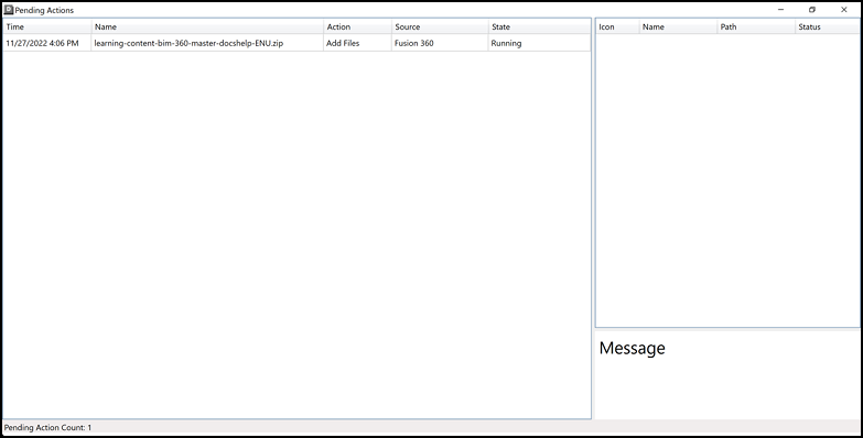

Pending Actions
Note: In previous versions, pending actions is accessed by clicking Pending Actions from the tray menu.
The main panel details:
  • Time
  • Name
  • Action
  • Source
  • State
Once your Fusion activities have successfully processed, they will disappear from the Pending Actions screen.

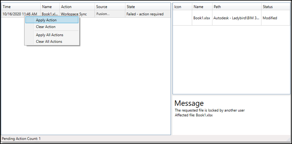

Resolve errors
Sometimes your Fusion activities error when they try to process. The message Failed – action required will display in the State column.
  1. Click the activity which has errored to display more details in the Message panel on the right, including the reason for the error.
    Pending Options Fusion
  2. Right-click an activity which has an error to display the following options:
    • Apply Action: This will retry the selected action.
    • Clear Action: This will discard the selected action.
    • Apply All Actions: This will retry all actions.
    • Clear All Actions: This will discard all the actions.
