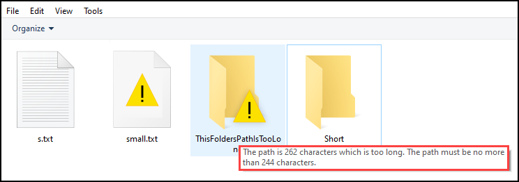

When navigating in Windows File Explorer, a file/folder will have a special icon indicating that its path has exceeded the limits. Also included will be a tooltip indicating the path length limit and the current path length of that file/folder.

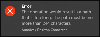

When attempting operations that would exceed the path limits on disk, the operation will either be blocked with an error message (typically seen as a bubble message from the tray) or the operation will skip over files/folders that exceed the path limit.

Attempting to navigate into a folder with path too long will show an error message.
Attempting to drag/drop files into a Desktop Connector workspace that would result in exceeding the path limit will be blocked with an error message.

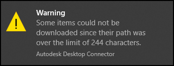

Attempting to download/open folders/files where some file paths are too long will complete the operation for files/folders that did not exceed the path limit. A warning will be issued if some files exceed the path limit.
