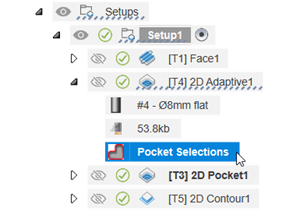

When selecting geometry for an operation, you can reference a geometry selection from another operation, even if the tool orientation is different.
  1. Create or edit an operation.
  2. In the operation dialog, in the Geometry tab geometry tab icon, click Select.
  3. In the Browser, under Setups, under an existing operation, select a previously defined geometry selection.
    geometry selection example
    The geometry selection appears on the canvas and in the Geometry Selections box in the dialog.
