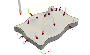

  4. Generate an Inspect Surface operation to specify which points to probe on the part's surface. The surface inspection results will be used to calculate the part alignment.
    inspect surface operation

  6. Import the inspection results in real-time as the NC code runs on the CNC machine.
    before and after example
    When all the inspection results have been imported, Fusion calculates the part alignment, and you must decide whether to approve or reject it.
    If you approve the part alignment, the NC code is automatically updated using the calculated part alignment. The work coordinate system (WCS) on the machine controller is adjusted so that the part can be machined accurately.
