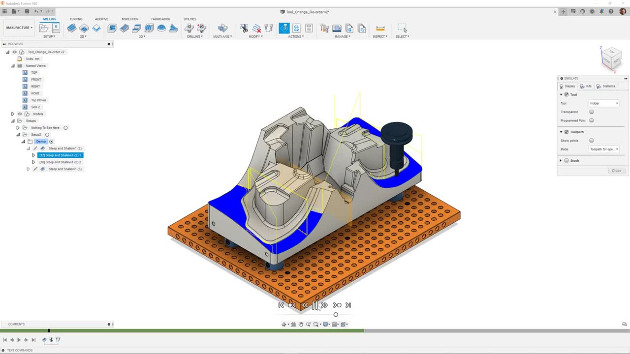

In the Browser, select the toolpath that you want to replace the tool on.
On the Manufacture workspace toolbar, click Milling > Modify > Replace Tool
.In the Replace Tool dialog, click Select to pick a tool. The Tool Library opens.
In the Tool Library, select a tool. The tool's tip geometry must be the same as the original tool, whereas geometry such as the tool length can be different.
Click Select to confirm your choice.
(Optional) Change any Feed & Speed values if necessary.
(Optional) To add notes as an aid to later recall why you were performing the modification, type some text in the Notes box. The notes appear when you place the pointer over the modification in the timeline.
Click OK. The newly selected tool is used on the toolpath without any toolpath recalculation.
