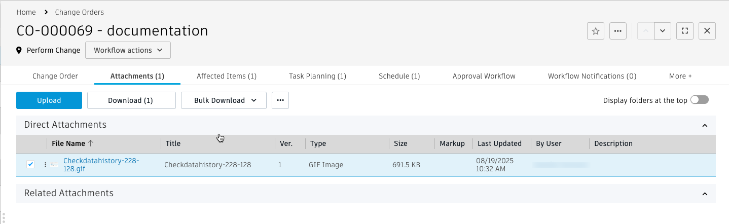

You can download the files attached to a change order.
  1. In the change order, click the Attachments tab.
  2. Select the files to download.
    selected item to download
  3. Click Download.
Bulk download files
  • In the Attachments tab, click Bulk Download and then select:
    • All Direct Attachments - only the files directly attached to the change order are downloaded.
    • All Related Attachments - only the related files are downloaded.
    • All Attachments - both direct attachments and related attachments are downloaded.
      The files are zipped and downloaded.
