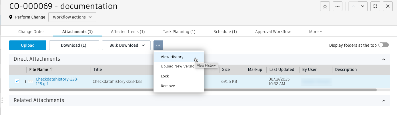

View the history of an attachment
  1. In the change order, click the Attachments tab.
  2. Select an attachment.
  3. From the Attachment menu (...), select View History.
    For each version of the selected file, the History dialog shows:
    • version number
    • file name
    • markup
    • date uploaded
    • file owner
    • description
      attachment more menu
  4. For any version, click Download alt to save that version of the file to your browser's download location.
Lock or unlock an attachment
If you lock an attachment, it and all its versions cannot be removed from a change order.
  2. Select the attachments you want to lock or unlock.
  3. From the Attachment menu (...), select Lock or Unlock.
Remove an attachment
  2. Select the attachments to remove.
  3. From the Attachment menu (...), select Remove.
  4. When prompted to confirm removing the files, click Remove.
