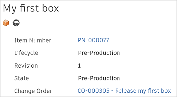

When viewing an item in the Fusion web client, you can see information about the current state of the item.

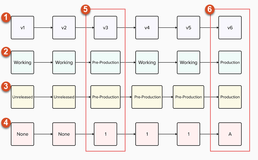

The following image outlines an example lifecycle of an item and indicates how and when the State, Revision, and Lifecycle values are updated. It is assumed the item has already been assigned a number.
Note: If you're working in a hub with collaborative editing, skip to this section.
item lifecycle example
  1. Version - A version is created every time you save a design or drawing.
  2. State - Indicates whether a specific version is in a working state (can be worked on) or is released to Pre-Production or Production.
  3. Lifecycle - Indicates the overall lifecycle phase the item is in. Items start as Unreleased then move to Pre-Production (using a quick release or a change order) or Production (using a change order).
  4. Revision - A revision is created when the item goes through a quick release or a change order. Numerical revisions are used when the item is sent to Pre-Production. Letters are used when the item is sent to Production.
  5. First change order – This change order was used to release version 3 of the item to Pre-Production. This means its Revision was set to 1.
  6. Second change order – This change order was used to release version 6 of the item to Production. This means its Revision was set to A. In between the first and second revision, the items Lifecycle state remains as Pre-Production, but its State changes to Working as further changes are made to the item.

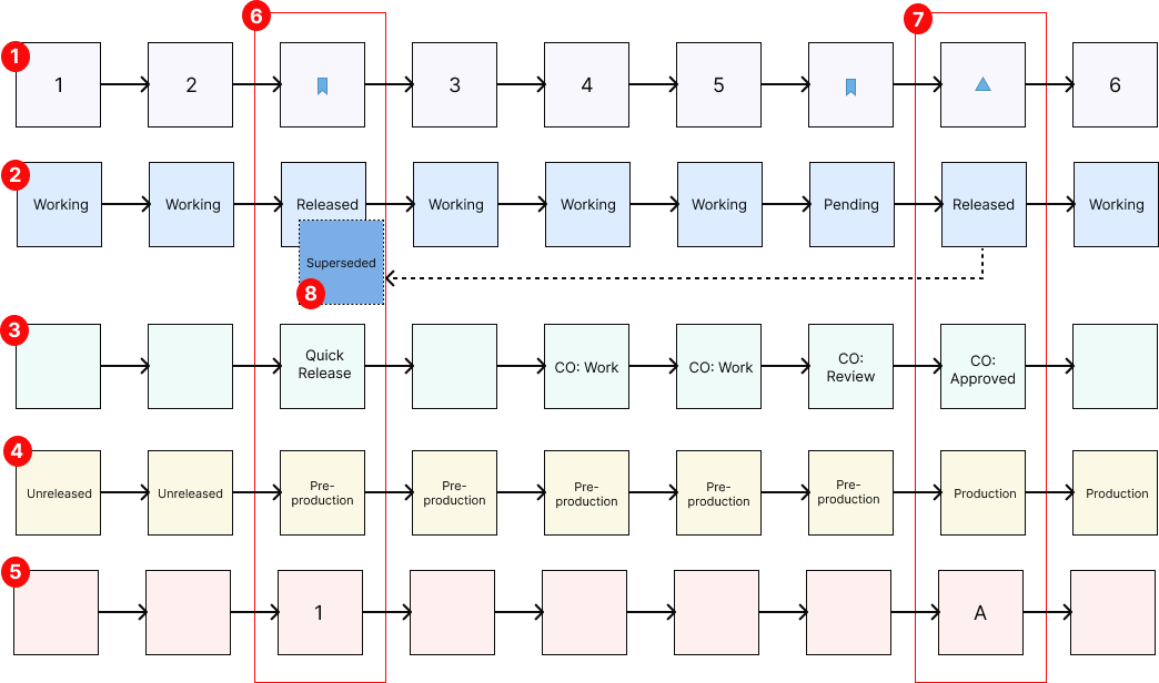

Item lifecycle example for collaborative hubs
Note: This item lifecycle example is only applicable if you're working in a hub with collaborative editing. Learn more about collaborative editing.
item lifecycle example diagram
  1. Change - Captured each time you save a design or drawing.
  2. State - Indicates a design or drawing is in a Working (currently under change), Pending release (currently under review), Released or Superseded state.
  3. Release process - Used when you revise a design or drawing.
  4. Lifecycle - Indicates the lifecycle phase of your item. Items start as Unreleased, move to Pre-Production (using a quick release or change order), then move to Production (using a change order), and finally move to Obsolete (using a change order).
  5. Revision - Created when your item goes through a quick release or a change order. Numerical revisions are used when the item is sent to Pre-Production. Letters are used when the item is sent to Production.
  6. Quick release - A quick release process was used to release the third change of the design or drawing to Pre-Production. The Revision is set to 1.
  7. Change order - A change order was used to release the sixth change to the design or drawing to production. This means its Revision is set to A. Between the first and second revision, the item's lifecycle state is Pre-Production, but its state changes to Working when further changes are made.
  8. Updated state - The State for Revision 1 changes from Released to Superseded when Revision A is released.
