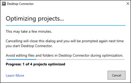

Avoid editing files and folders locally while the project optimization is running.
What do I need to do?
No action is required. When Desktop Connector starts for the first time after upgrading to 16.11 the optimization will automatically begin. The dialog will inform you of the number of projects that need to be optimized and display the progress.

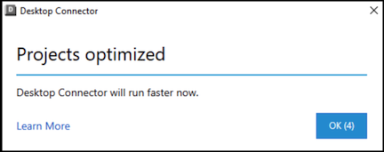

Once complete, the following message will be shown and close after 5 seconds.
At this time you can resume using Desktop Connector.
What happens if I cancel?
If you do not want to wait for the optimization to take place you can choose to cancel. Each time you start Desktop Connector the optimization process will start again until all of the existing projects are optimized.
