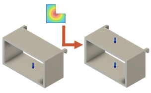

The Clone Study command provides a quick way to create multiple studies that you can then modify to simulate different analysis conditions.
The Clone Study command instantly creates new studies for the same simulation model, with the same study settings as the original study. To save time, set up the first study completely then clone it and make changes to your cloned study, such as different loads. You can then compare the results of the new study with those of the original study.
