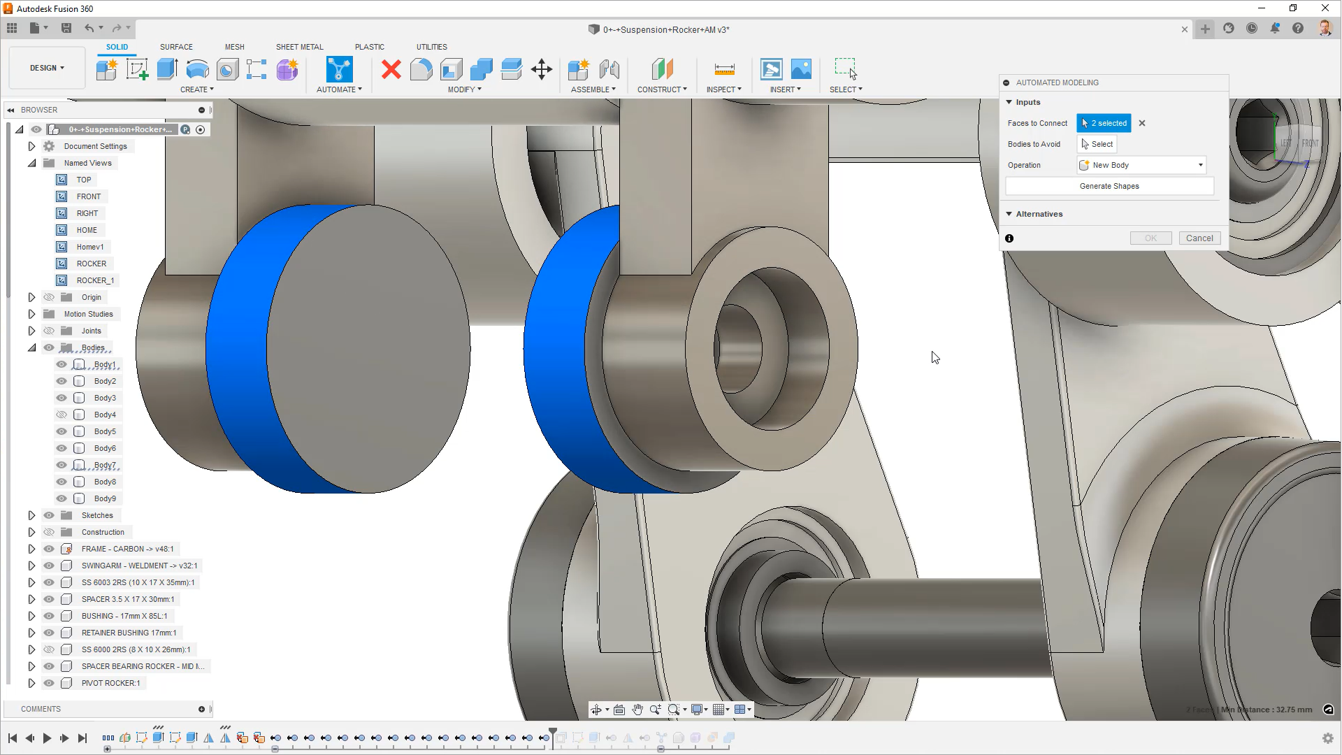

Best Practices - Faces to Connect
The faces you select have a big impact on the generated design alternatives. Following these guidelines can help ensure that you quickly generate good-quality design alternatives:
  • Simplify your model to improve the speed and quality of design alternatives. You can remove bodies or features that are not relevant to the geometry you want to create using the Automated Modeling tool. For example, removing features such as fillets, chamfers, holes, or pockets that can complicate a generation of design alternatives and replacing selected objects with primitive shapes.
    simplify
  • Divide a single face on a body into two faces that remain on the same body using the Split Face tool to control more precisely where the generated new geometry connects to the existing body. This helps you specify where the connection will be made.
    split faces
  • Avoid faces that are very small in proportion to the size of the geometry you want to create.
    small faces
  • Use the Automated Modeling tool multiple times, with a smaller selection of faces, if you want to connect many faces together. Selecting a lot of faces may increase the time needed to generate design alternatives.

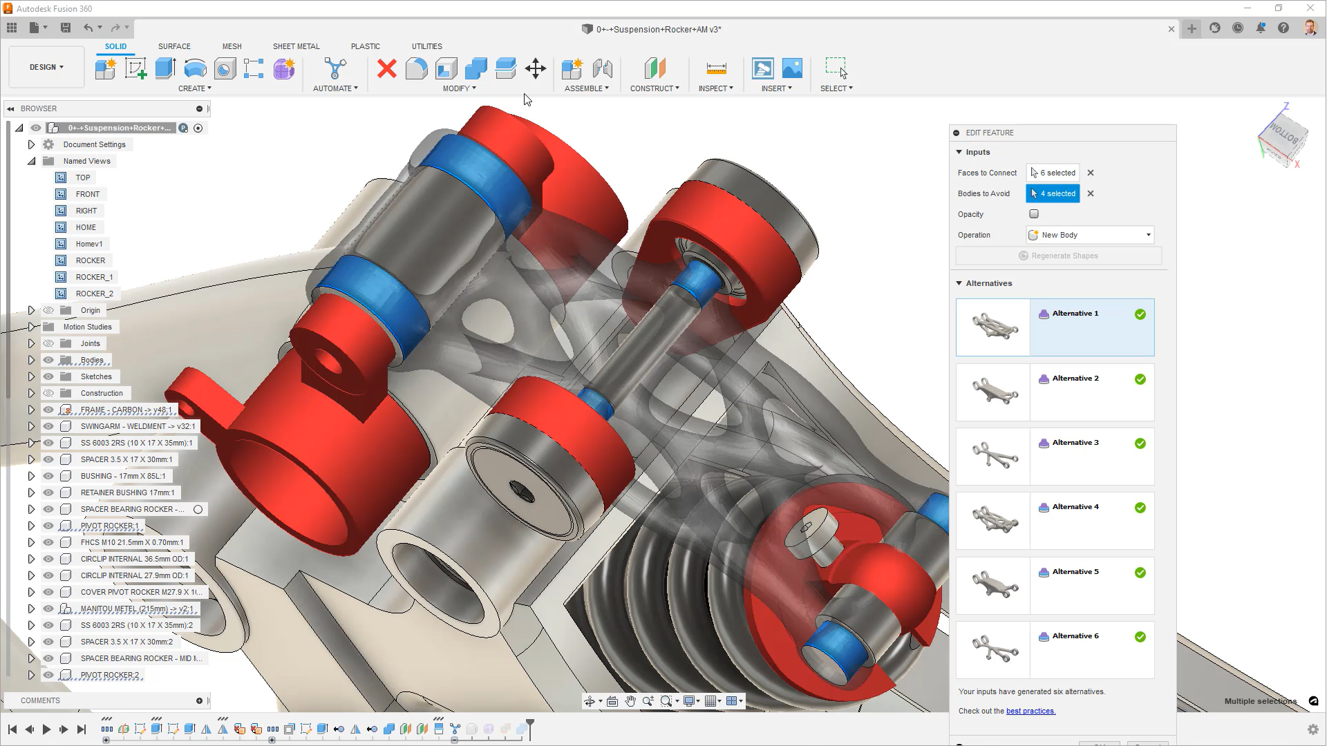

Best Practices - Bodies to Avoid
Specifying Bodies to Avoid is optional and you can generate design alternatives without it. However, in some cases it will be necessary to prevent new geometry from being generated in certain areas of the design.
  • Create new bodies, which you then select as Bodies to Avoid, in places where a new geometry should not interfere with other assemblies in the design. This can be used to represent clearances, human interaction, or moving components.
    bodies to avoid
  • Create new bodies, which you then select as Bodies to Avoid, to create different types of shapes that may be more aesthetically pleasing and interesting.
    bodies to avoid
  • Select internal, rather than external, faces on a solid body if you want Automated Modeling to be able to generate shapes around that body. When you select an external face as a Face to Connect, the rest of the body automatically becomes a Body to Avoid so Automated Modeling will not be able to generate shapes around the body. It's important in case if you want to connect faces in the existing design.
    bodies to avoid external faces
