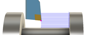

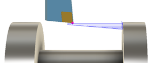

You can machine undercuts, commonly in the form of grooves, using the Profile Roughing strategy. After selecting a non-grooving tool, a Machine Undercuts option appears in the Passes tab to let you machine undercuts.
Machine undercuts deselected so the groove is not machined Machine undercuts selected so the groove is machined
Deselected Selected

When machining undercuts, you can specify a clearance between the back of the holder or the back of the insert and the model. This clearance is useful to help avoid collisions.
Clearance from back of holder
