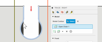

  4. On the Geometry tab, select a model contour from the model or sketch to drive the toolpath.
    Select a sketched contour as the model contour

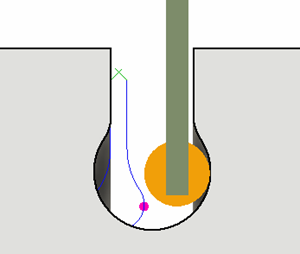

    turning trace toolpath generated
