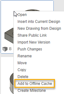

Cache a design or folder
  1. In the Application bar, click Job Status job status icon to verify you are Working Online working online icon.
  2. In the Fusion Data Panel, right-click a file or folder.
  3. Select Add to Offline Cache.
    data panel right-click add to offline cache
  4. Optional: In the Application bar, click Job Status job status icon to monitor progress as the design or folder caches.
    job status update offline cache
The design or folder is saved to your local cache and is available offline.
