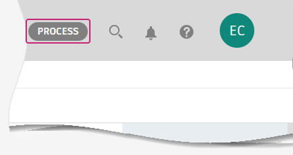

Open the Fusion web client.

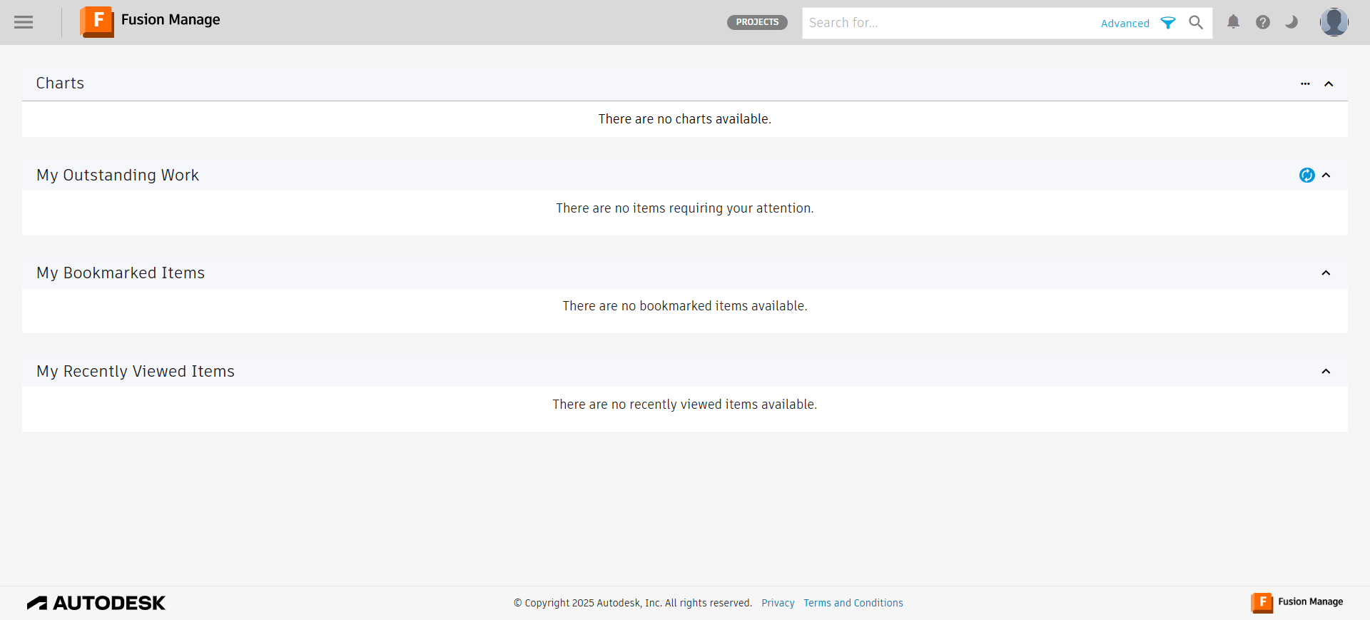

At the top of the page, click Process.
The Fusion Manage Extension site opens to the main dashboard.

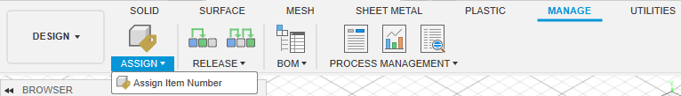

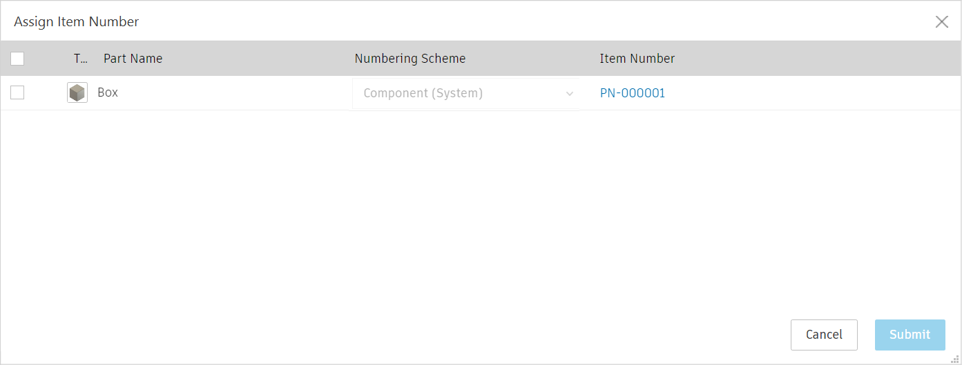

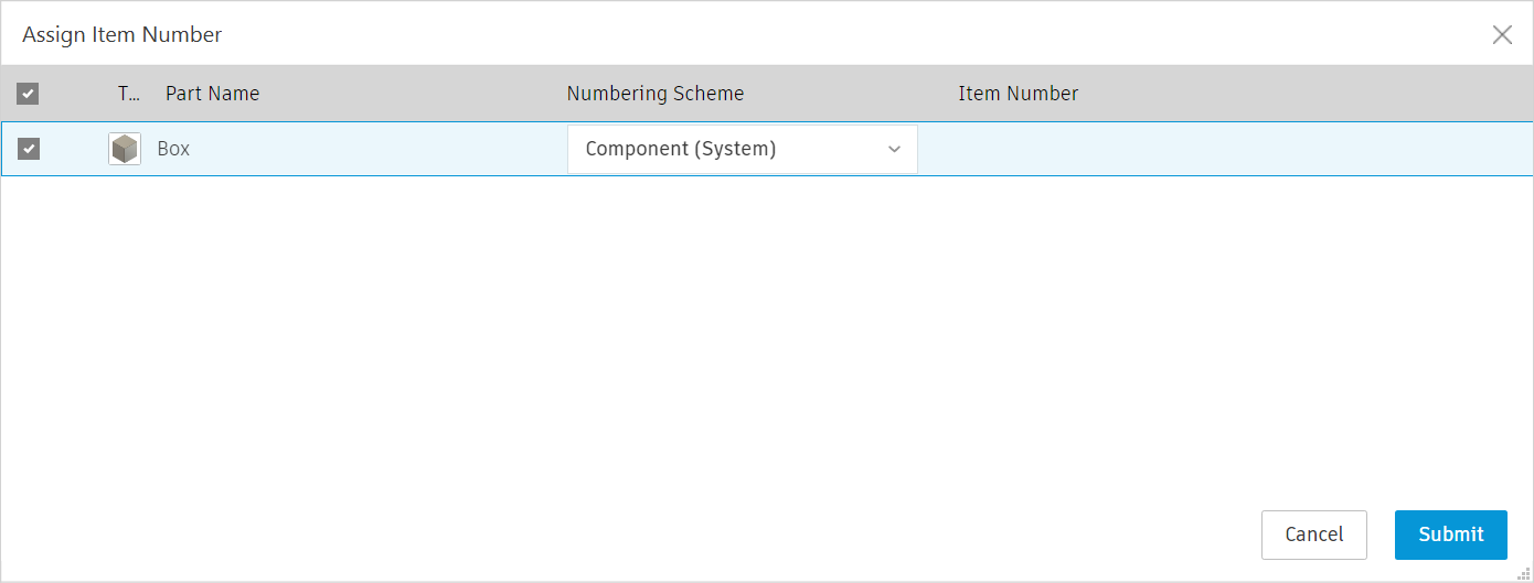

From the Manage tab, click Assign > Assign Item Number.
Note: For now, you’ll use the default item numbering scheme. In another tutorial, you’ll configure new item numbering rules.Select the item, then click Submit. Wait for the item number to be assigned, then close the window.
This has created an item for the component in the Fusion Manage Extension site.

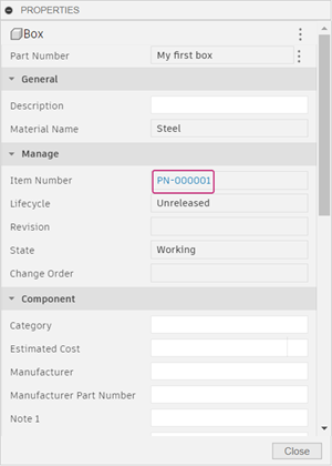

Open the Properties for the component.

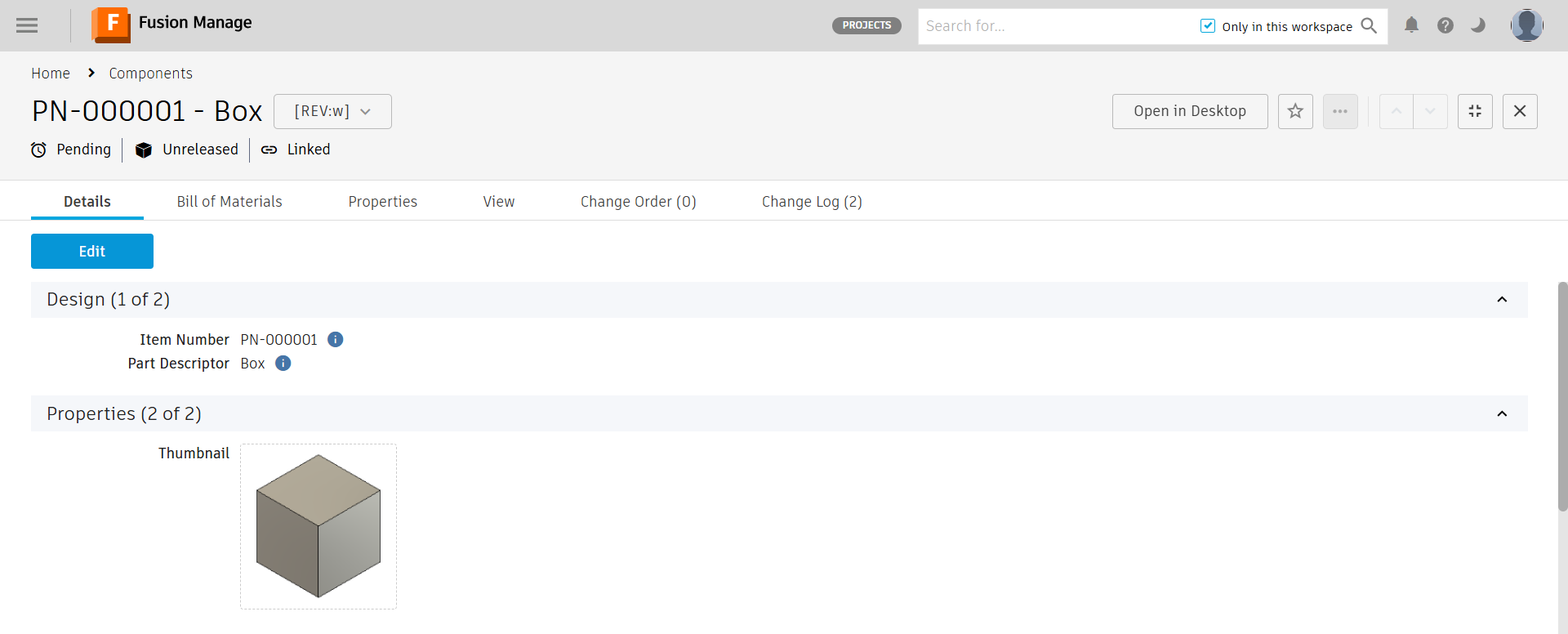

From the Manage section, click the item number.
The Fusion Manage Extension site opens to the item in the Components workspace.

From the Manage tab, click Details in the Process Management section.
Tip: Click the other buttons in the Process Management section to see what they open.
