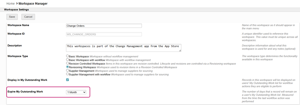

The first option under each workspace is the Workspace Settings. Here, you have the option to change the workspace name, description, and type.
Beside the workspace name, you can see that each workspace is a different type: Basic workspace, Basic workspace with workflow, Revision Controlled Workspace, Revisioning Workspace. See About Workspaces for descriptions of what each type means for the behavior of the workspace.

For the Change Orders, Change Requests, Change Tasks, and Problem Reports workspaces, set the Expire My Outstanding Work option to be at least a month so that it does not impact the load time of your main dashboard.

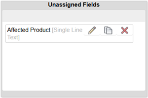

Retain existing fields as they are as modifying or deleting them could lead to unexpected results.
Move a field to the Unassigned Fields list on the left so that you can test the result of removing the field without deleting it completely. That way, if something does go wrong, you can reinstate it.

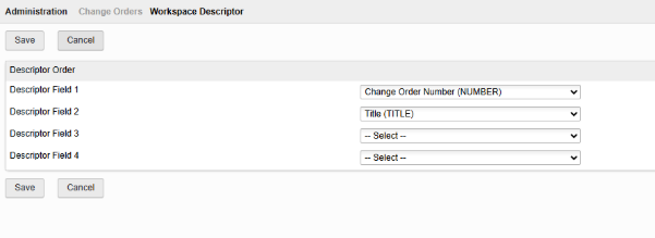

Set a workspace descriptor
Every item in the Fusion Manage Extension has a title or header called a Descriptor. Descriptors are set up individually for each workspace to provide a descriptive name for each item in that workspace. You select several fields from the Item Details section (up to 4) that make up the descriptor. See Specify Descriptor Fields for further information on this.
Recommendations
- Set the Descriptor to use the workspace Item Number and Title as making use of other paragraph or lengthy fields can lead to confusing headers.

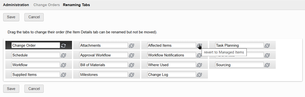

Modify tab names
The Tab Names settings enable you to rename the tabs that appear on items in a workspace. In the default setup, many tabs have been renamed as follows:
- The Item Details tab is typically renamed to match the name of the workspace.
- In many workspaces the Managed Items tab is renamed to Affected Items.
- The Grid Tab is renamed to Task Planning in the Change Requests and Change Orders workspaces. In the Change Approval Templates workspace, it is renamed to Change Tasks Template.
- For workspaces that are governed by workflows, the Workflow tab is sometimes renamed to better capture what the workflow does, for example, Approval Workflow.
Recommendations
Place your pointer over the Reset
icon to see what the original tab name is. When first exploring these settings, you might find it confusing to know which tab is which.
Feel free to rename and rearrange tabs as you see fit.
