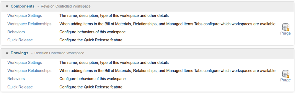

Within the Workspace Manager, you'll notice that you have two workspaces with significantly reduced settings: Components and Drawings. These are called 'system workspaces' because they are tightly integrated with Fusion and therefore have limited administration capabilities so as not to break that link.
