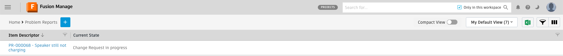

  1. From the Dashboard menu dashboard menu, click Workspaces.
  2. Go to Workspaces > Change Management > Problem Reports.
    list of problem reports
  3. Click the Create icon, enter the required fields.
  4. Click Save.
    The problem report automatically forwards the given information to specified process owners for analysis and problem resolution.
