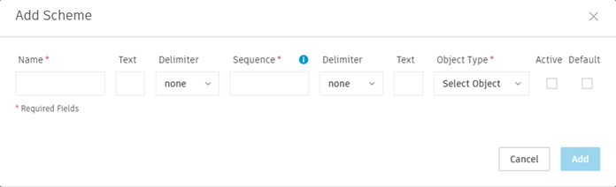

  3. Click Add Scheme.
    add scheme
  4. In the Add Scheme dialog, enter information for the new scheme.
    • Name: The name people will see when choosing this scheme; for example, Drawing.
    • Text: Use these two boxes to enter a prefix and suffix for the scheme; for example DRW.
    • Delimiter: Use these two boxes to select a character for separating segments of the scheme.
    • Sequence: Numerical starting point for the scheme; for example a single digit like 1, or a padded value like 001.
    • Object Type: Select the type of object this scheme will be used for; for example, select Drawing if you are creating a scheme that you specifically want to use for drawings.
    • Active: Makes the scheme available when generating item numbers.
      Deselecting this can be useful if the scheme wasn't created properly or is no longer in use, since schemes can't be edited or deleted.
    • Default: Makes this the default scheme when generating item numbers.
  5. Click Add.
