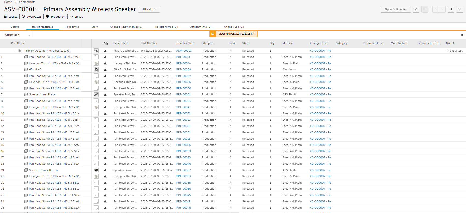

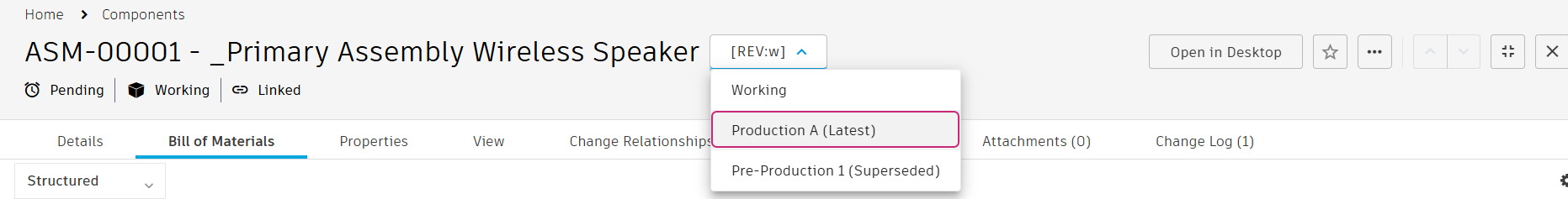

  3. Show the released BOM.
    1. At the top of the page beside the item name and number, click the revision drop-down and select Production (Latest).
      select production latest revision
      The revision drop-down shows [REV:A] once you've selected the revision you want to view. The bill of materials updates to show the BOM for the released Wireless Speaker.
      released BOM in FME

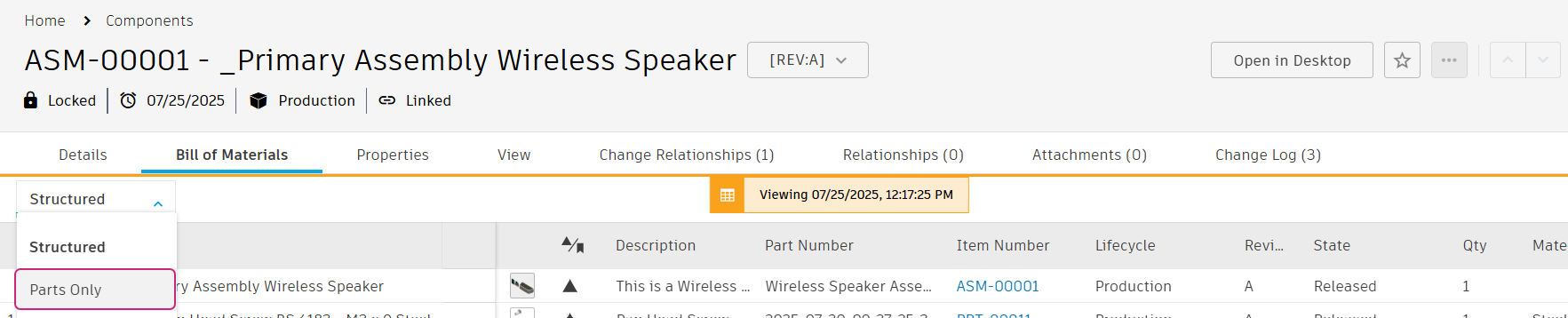

  4. Show the parts list.
    1. In the top-left corner, click the Layout Switcher drop-down and select Parts Only.
      select layout switcher parts only

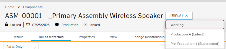

    1. Change the filters to show the full structure of the Working BOM.
      Note: This is because you can only edit properties in the BOM only when the component is in a Working state and not Released.
      set revision to working

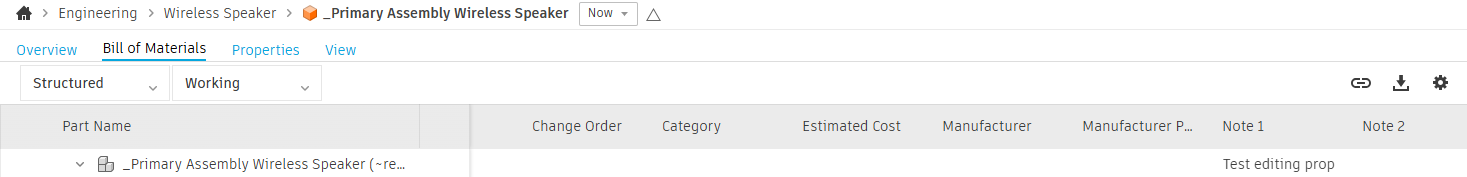

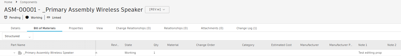

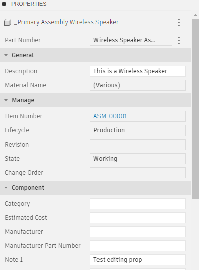

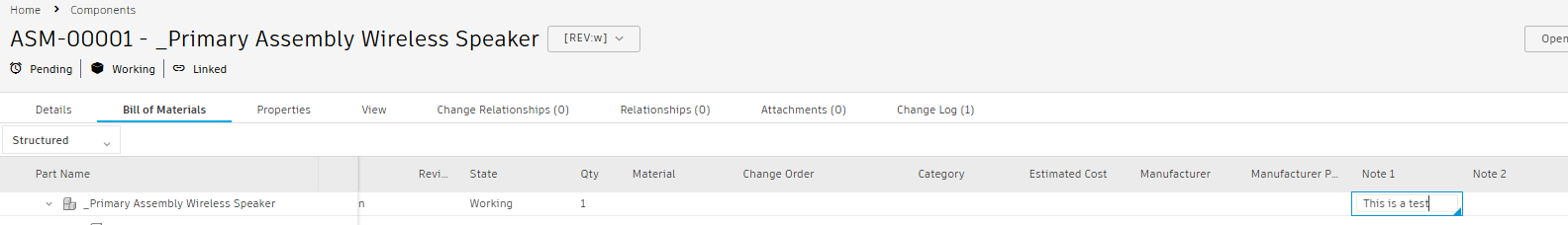

    2. In the Wireless Speaker row, double-click the Note 1 field.
      double-click
    3. Enter new text into the box, then press Enter or Tab.
      edit note 1 field
    4. View the Wireless Speaker properties in the Fusion desktop client (properties panel, BOM table) and confirm they have been updated there as well.

  6. Repeat the above in the Fusion web client.
    1. At the top of the page under the item name and number, click Linked.
      click linked
      This takes you to the component in the Fusion web client.
    2. Open the Bill of Materials tab.
      BOM tab fusion web client
    3. Explore the functionality here to see that it is the same as the other locations you've explored.
