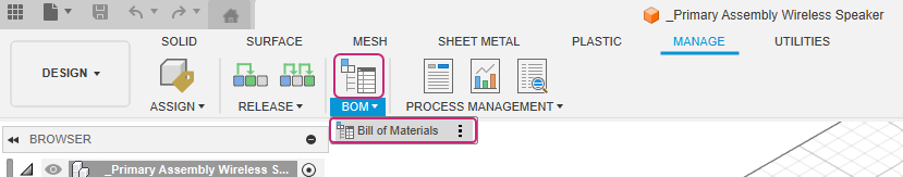

  2. Open the bill of materials.
    • Option 1: From the Manage tab, click BOM > Bill of Materials.
      manage BOM tab

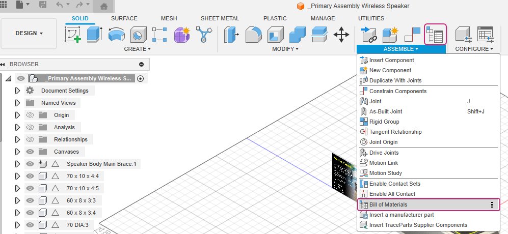

    • Option 2: From the Solid tab, click Assemble > Bill of Materials.
      assemble tab BOM

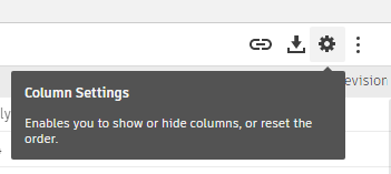

  3. Configure the columns to include the Notes columns.
    1. In the top-right corner, click the Column Settings icon.
      column settings
    2. Click to select the Notes columns and any others you want to include.
      Note: Skip this step if these columns are already preselected.
    3. Click and drag the column headings into the order you want.
      Your settings are saved automatically, and the BOM opens this way from now on until you change or reset it.

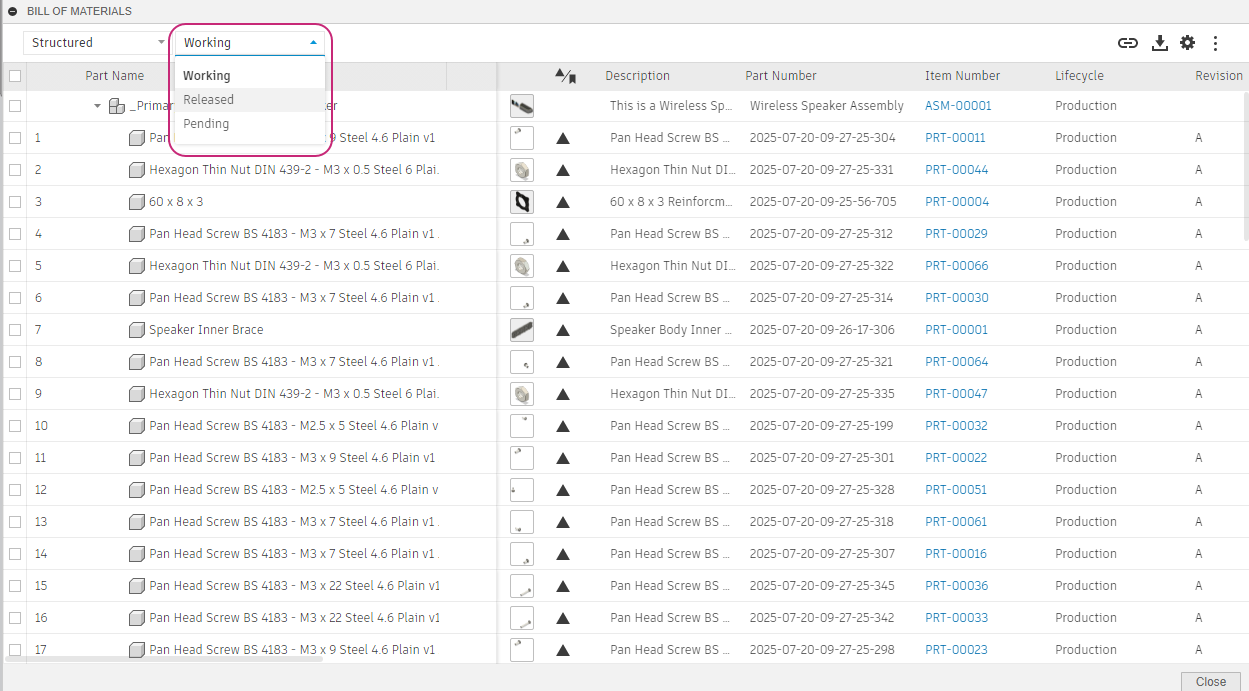

  4. Show the released BOM.
    1. In the top-left corner, click the BOM Switcher drop-down and select Released.
      BOM switcher

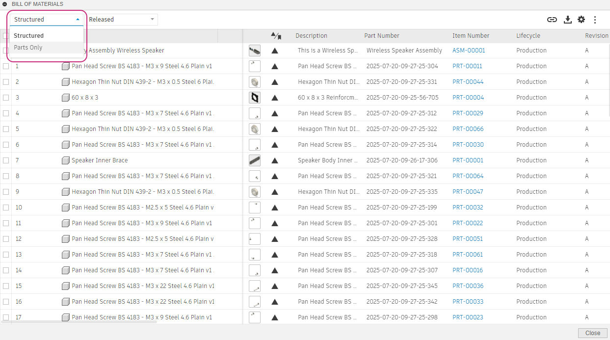

  5. Show the parts list.
    1. In the top-left corner, click the Layout Switcher drop-down and select Parts Only.
      layout switcher

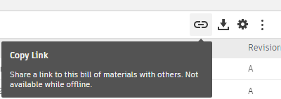

  6. Share the BOM with a chosen structure.
    1. In the top-right corner, click the Copy Link icon.
      copy link BOM

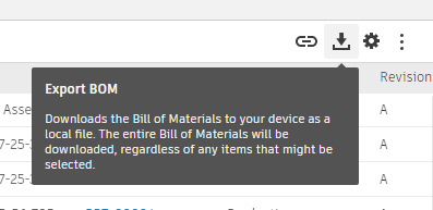

  7. Export the released BOM.
    1. In the top-right corner, click the Export BOM icon.
      export BOM
