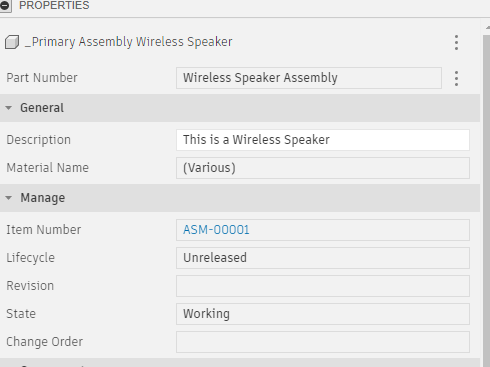

  2. Observe the current Manage properties of the Wireless Speaker.
    1. Open the Fusion desktop client.
    2. Open the Wireless Speaker assembly for which you have assigned an item number in the previous tutorial.
    3. Open the properties of the model.
    4. Scroll down to the Manage section.
      speaker properties
      Notice that the Lifecycle is Unreleased and the State is Working.

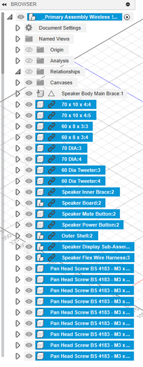

  3. Send the Wireless Speaker and all of its components except the Speaker Body Main Brace component to a change order.

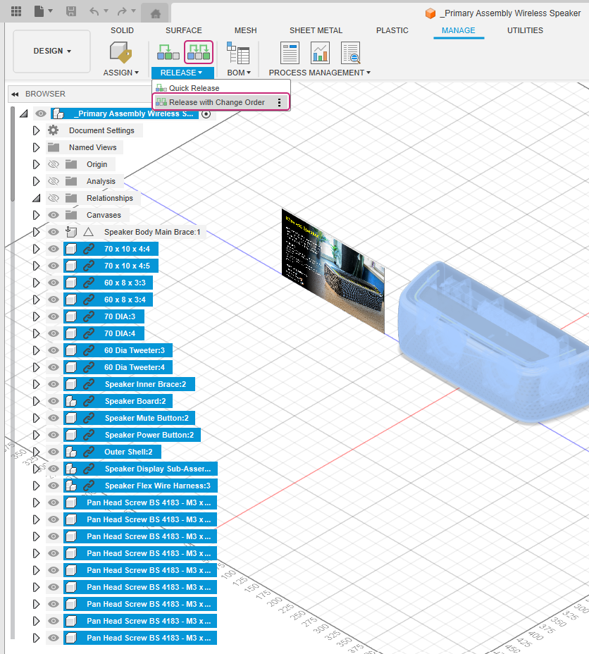

    1. From the Browser, highlight each component (except the Speaker Body Main Brace) as well as the Wireless Speaker.
      highlight components
      Tip: Press and hold the Ctrl key while you select items from the bottom up.
    2. From the Manage tab, click Release with Change Order.
      release with CO

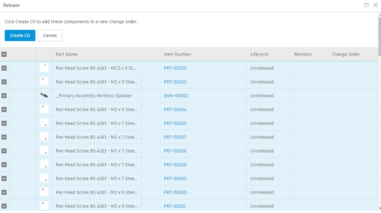

    3. Ensure the Wireless Speaker assembly with all its components except the Speaker Body Main Brace component is selected, then click Create CO.
      create co
      Note: If any components didn't have an assigned item number, it would be assigned now.

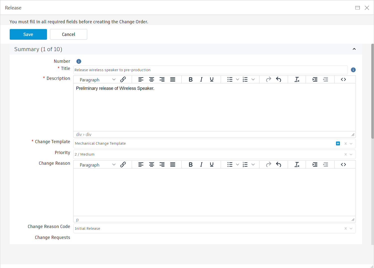

  4. Configure summary details for the CO.
    1. Enter a value for the Title, for example Release Wireless Speaker to Pre-Production.
    2. In the Description field, enter more information regarding the CO, for example Preliminary release of Wireless Speaker.
    3. From the Change Template drop-down, select an appropriate change template.
      If one does not exist, you might be able to create one if you have the correct permissions. Click the Quick Create create change template icon to create one. See Tutorial 4: Change templates for steps on how to create a change template that is used for these tutorial examples.
    4. Optionally set the Priority as Medium. This can help prioritize work when there are multiple COs to manage.
    5. Optionally, click the Change Reason Code drop-down list and select Initial Release. This can help to categorize COs.
      CO form details
    6. Click Save.

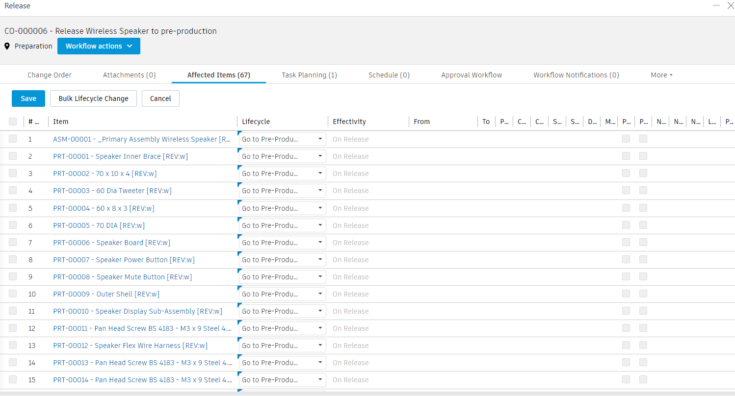

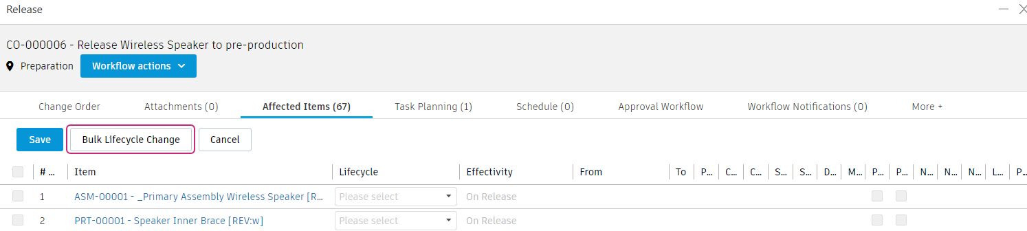

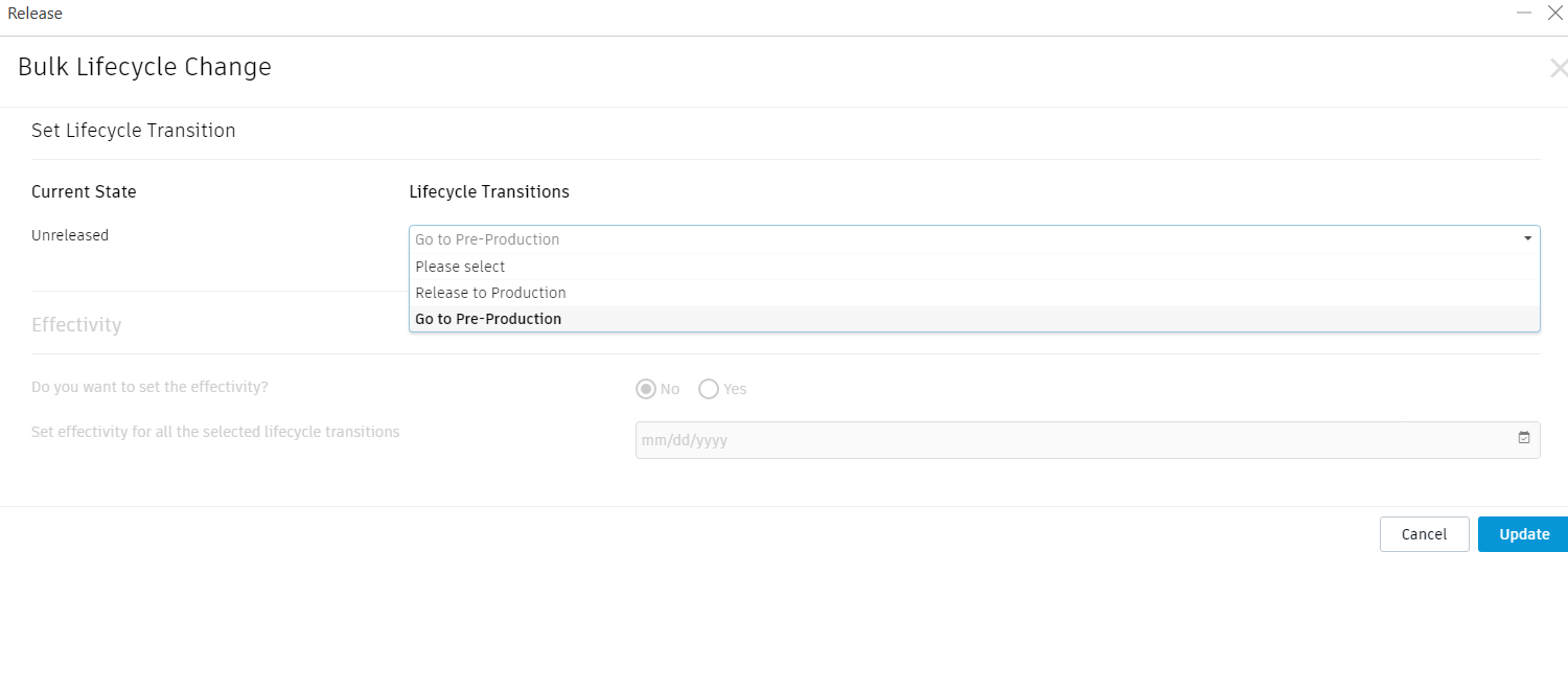

  5. Set the lifecycle to Pre-Production for the selected components.
    1. In the Affected Items tab, click Save, then click Bulk Lifecycle Change.
      bulk lifecycle
    2. Select Lifecycle Transitions as Go to Pre-Production.
      set lifecycle
    3. Click Update.
    4. Click Save.
      lifecycle change result

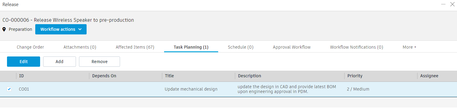

      Note: At this point, if you chose a change template that contains tasks that were copied into this CO, you must remove them before you can submit the CO for review. Locate tasks in the Task Planning tab, select each one, then click Remove.
      remove tasks

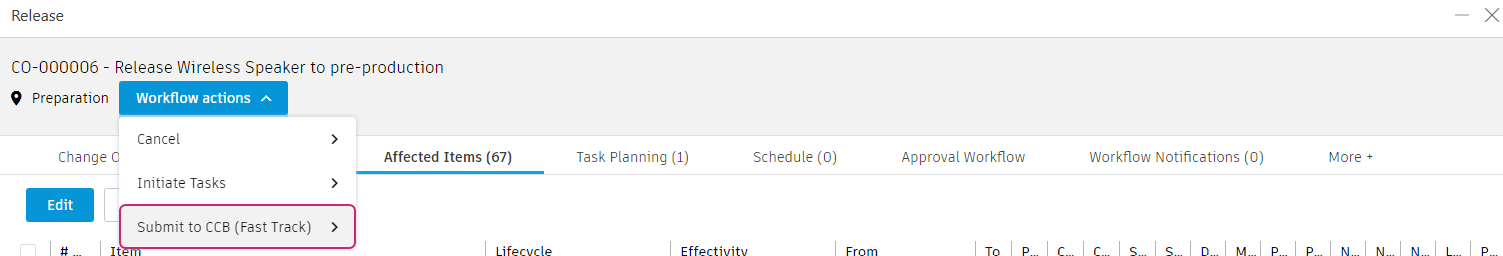

    1. Open the Approval Workflow tab and note the change order workflow.

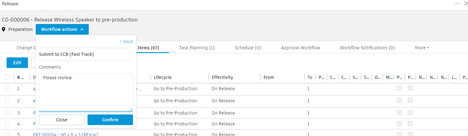

    2. Click the Submit to CCB (Fast Track) transition. Alternatively, from the Workflow Actions drop-down menu, select Submit to CCB (Fast Track).
      submit to ccb
    3. Optionally enter a comment, then click Confirm.
      CO comments

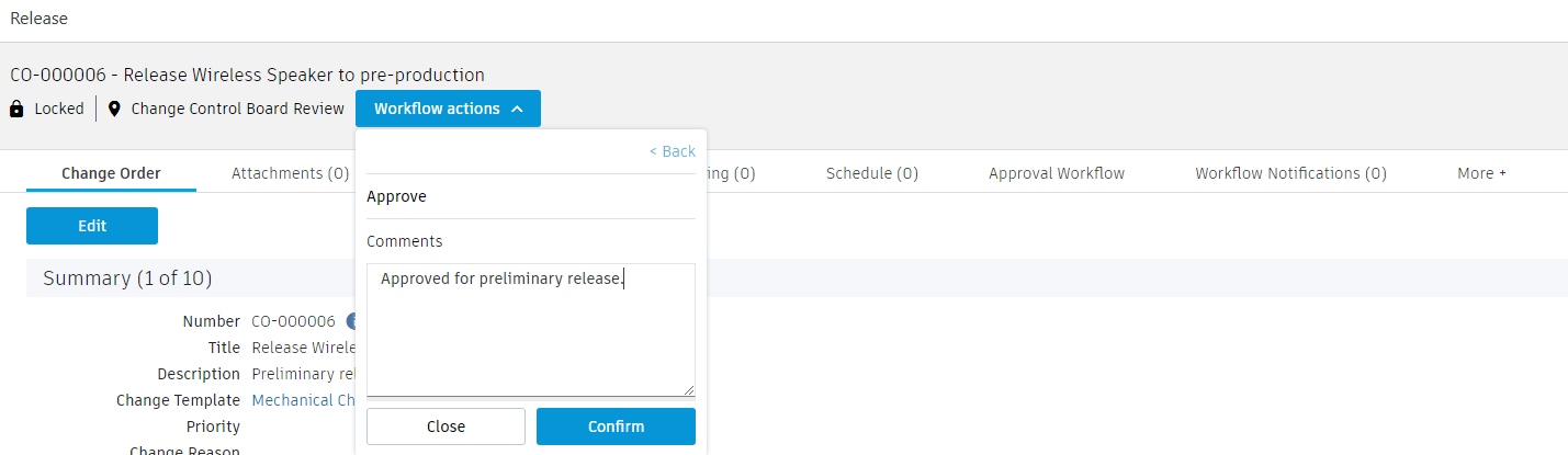

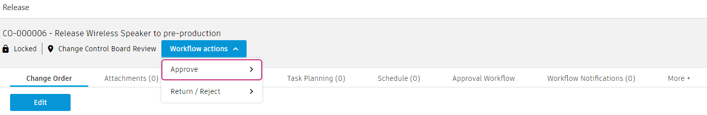

    4. While the CO is in the Change Control Board Review state, click the Approve workflow action.
      approve CO
      Note: Only the people specified in the change template in the CO Approver field can approve a CO.
    5. Optionally enter a comment, then click Confirm.
      CO comment

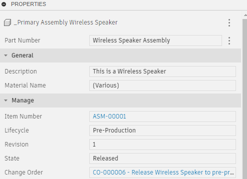

  7. Observe the updated Manage properties of the Wireless Speaker.

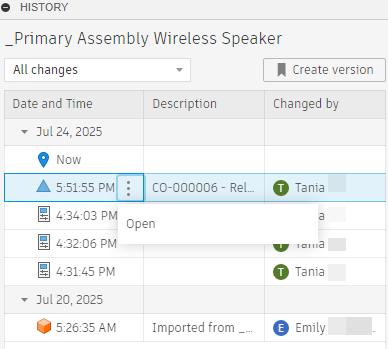

    1. From the Browser, right-click the Wireless Speaker and select History.
    2. Beside the row that shows the blue revision triangle, click the three-dot menu icon and select Open.
      open from history
      Note: This step is necessary because in the Fusion desktop client, a working version of the model is always available as the latest model and this would show incorrect lifecycle information.
    3. From the Browser, right-click the Wireless Speaker and select Properties.
      speaker properties
      Notice that its Lifecycle is Pre-Production, Revision is 1, and State is Released. Also, note there is a link to a change order.

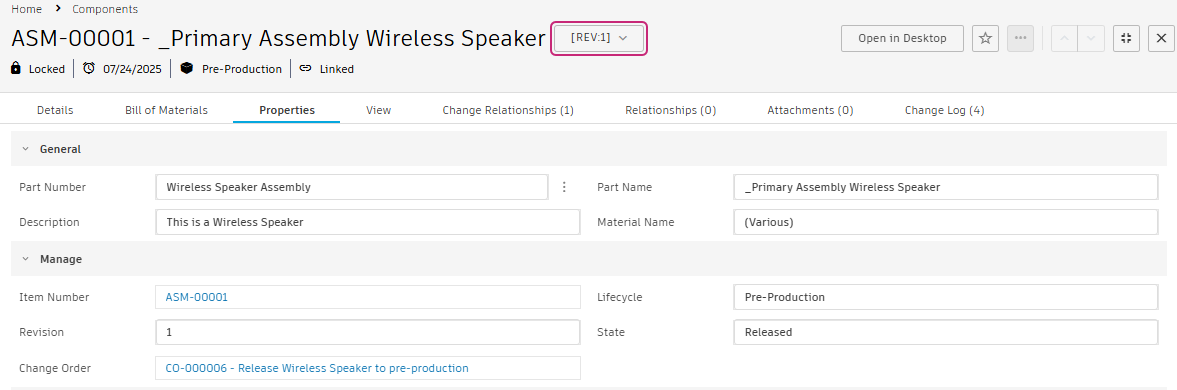

  8. View the released item in the Fusion Manage Extension site.
    1. From the Wireless Speaker properties panel, click the Item Number.
      The item opens in the Fusion Manage Extension site.
    2. From the Revision drop-down at the top of the page, choose Rev:1.
    3. Open the Properties tab and view the Manage properties section.
      item rev 1
