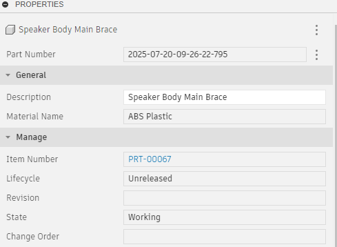

    3. From the Browser, right-click the Speaker Body Main Brace component and select Properties.
    4. Scroll down to the Manage section.
      properties
      Notice the Lifecycle as Unreleased and State is Working.

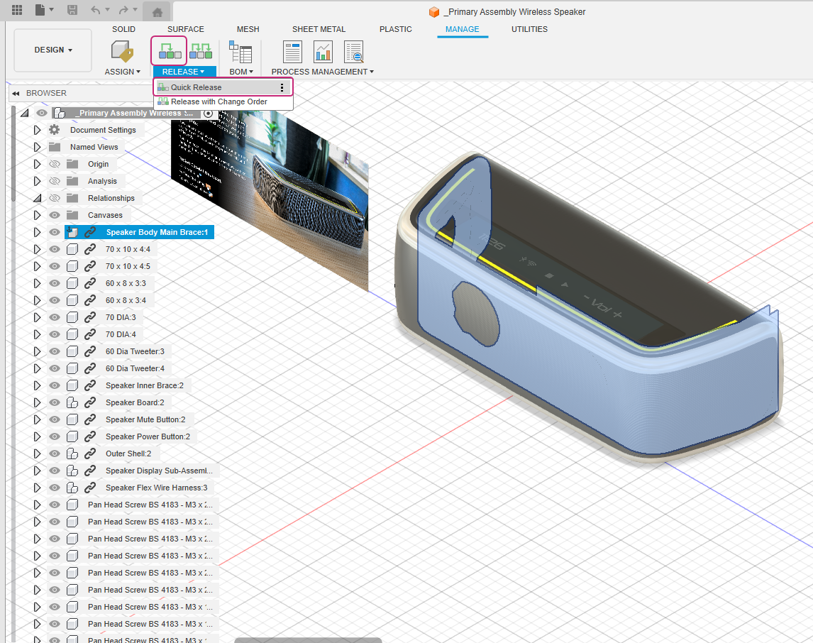

    1. From the Browser, highlight the Speaker Body Main Brace component.
    2. From the Manage tab, click Quick Release.
      highlight component

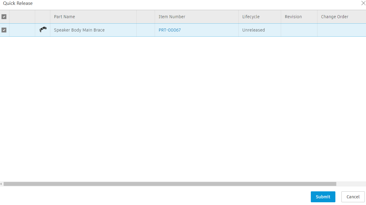

    3. In the Quick Release window, click Submit.
      qr submit

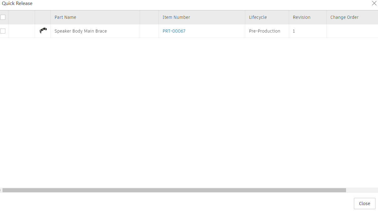

    4. Wait for the process to complete, then close the window.
      qr result

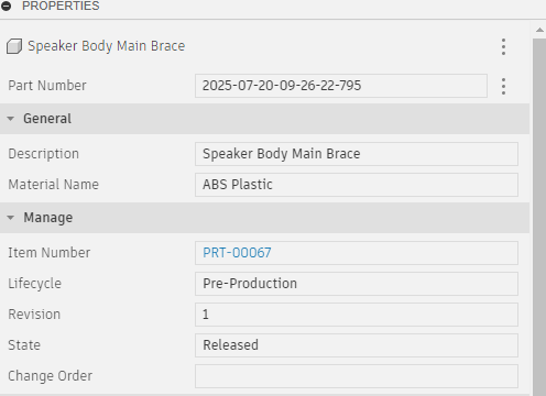

  4. Observe the updated Manage properties of the Speaker Body Main Brace component.
    1. Open the properties for the Speaker Body Main Brace component.
    2. Scroll down to the Manage section.
      updated properties
      Notice now that the Lifecycle as Pre-Production, its Revision is 1, and there is no Change Order link.
