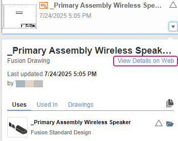

  1. Take note of the Wireless Speaker drawing's item number.
    1. From the Data Panel, locate the drawing and click View Details on Web.
      view details on web

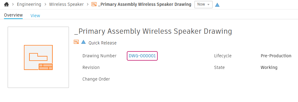

    2. In the Overview tab, take note of the drawing item number.
      drawing item number

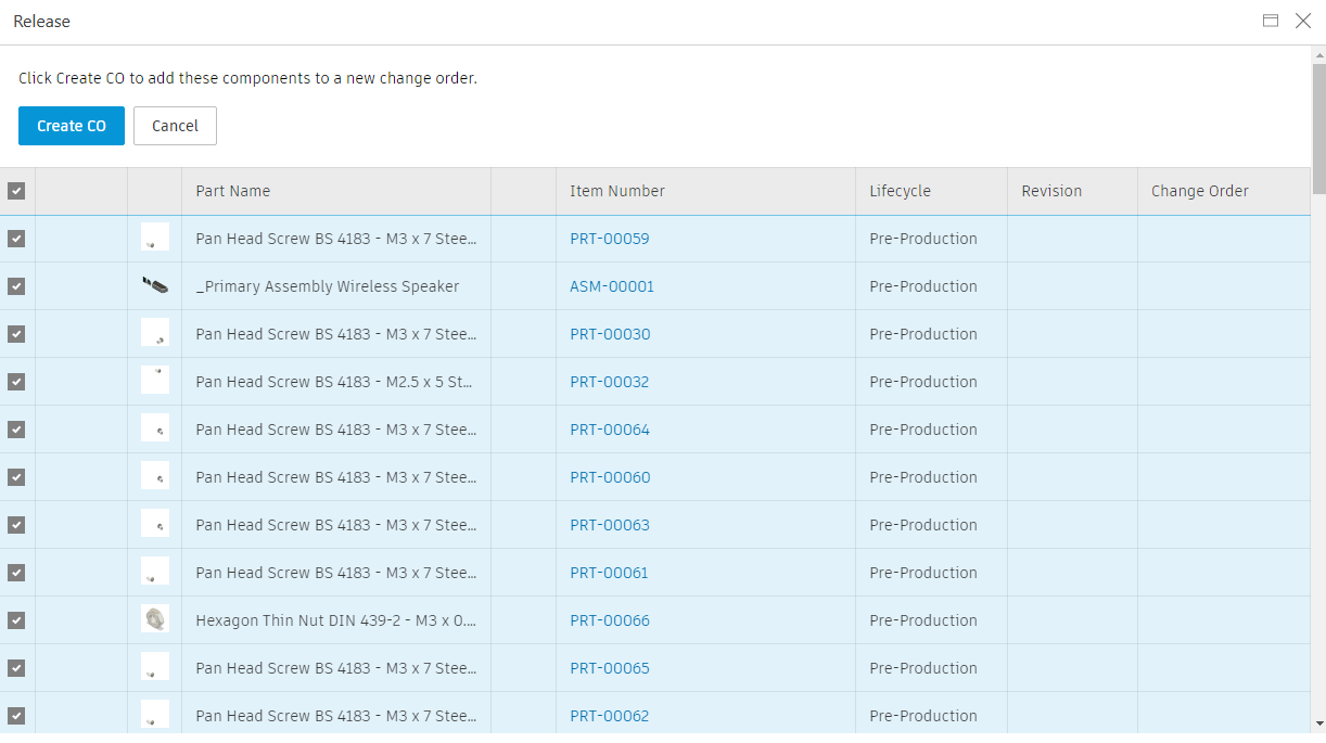

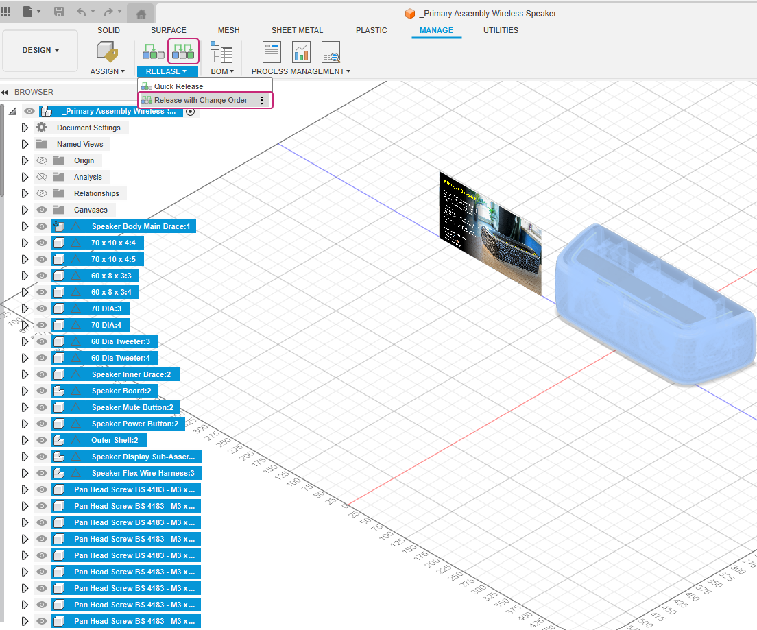

  2. Send the Wireless Speaker and all of its components to a change order.
    1. In the Fusion desktop client, open the Wireless Speaker.
    2. In the Browser, highlight all components.
    3. From the Manage tab, click Release with Change Order.
      release with change order
    4. Ensure the Wireless Speaker and all of its components are selected, then click Create CO.
      create change order

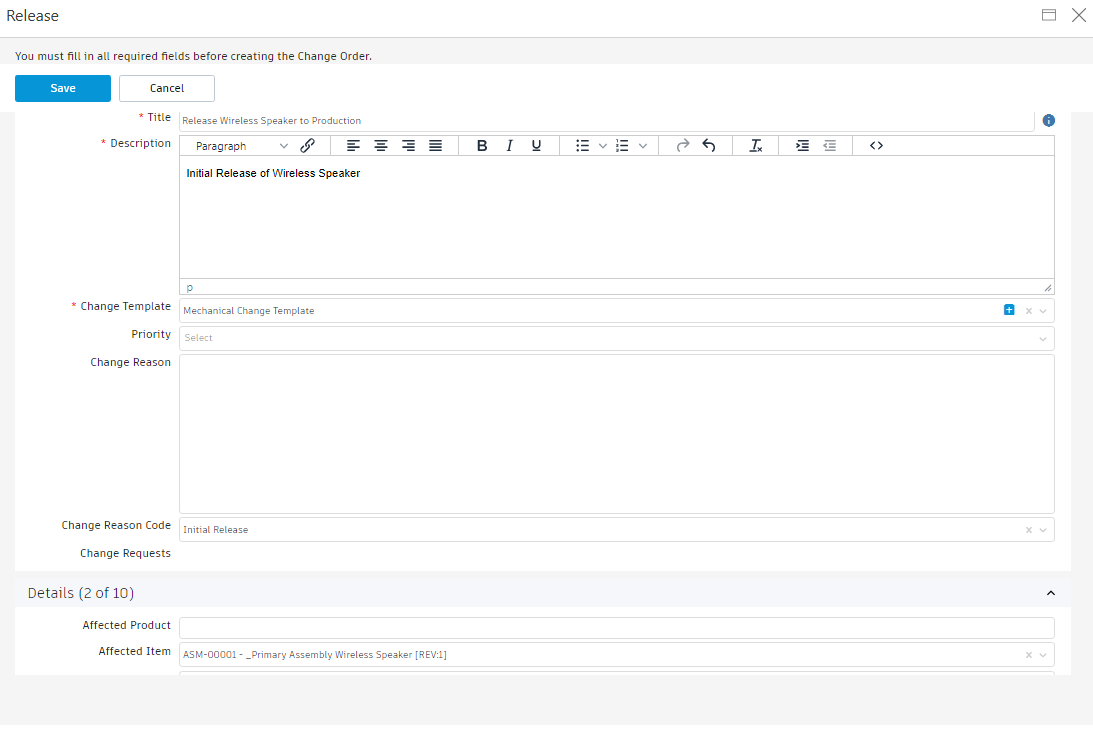

  3. Configure summary details for the CO.
    1. Enter a value for the Title, for example Release Wireless Speaker to Production.
    2. In the Description field, enter more information regarding the CO, for example Release Wireless Speaker to Production.
    3. From the Change Template drop-down, select an appropriate change template.
      If one does not exist, you might be able to create one if you have the correct permissions. Click the create change template symbol to create one. See Tutorial 4: Change templates for steps on how to create a change template that is used for these tutorial examples.
    4. Optionally set the Priority as Medium.
    5. Optionally, enter text in the Change Reason field, for example Release of Wireless Speaker to Production.
    6. Optionally, click the Change Reason Code drop-down list and select Initial Release.
      fill form details
    7. Click Save.
      Note: Expand the Stakeholders section. Notice that the Coordinator field has been populated with the CO Coordinator value that was set in the change template. In the Approvals & Confirmation section, notice that the Required CCB Approvers has been populated with the CO Approvers value that was set in the change template.

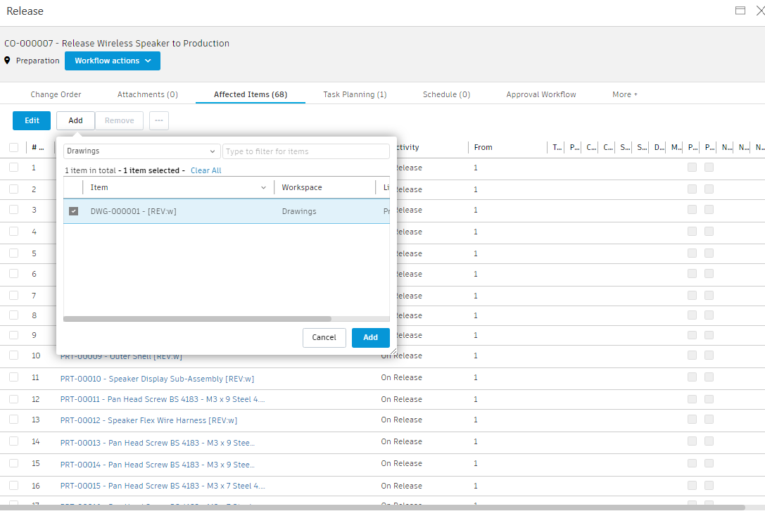

  4. Add the drawing to the CO.
    1. From the Affected Items tab, click Add.
    2. From the workspace selector, select Drawings.
    3. In the Filter box, begin typing the drawing number.
    4. Select the drawing that accompanies the model and click Add.
      add drawing to affected items

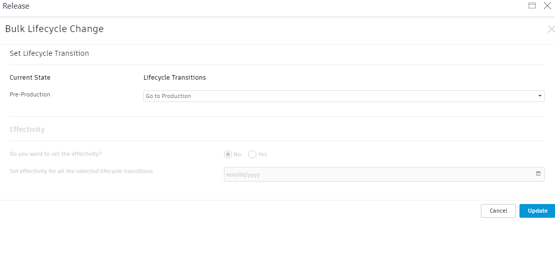

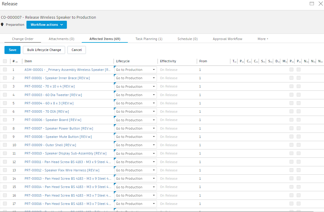

  5. Set the lifecycle to Production for all components and the drawing.
    1. In the Affected Items tab, click Edit.
    2. Click Bulk Lifecycle Change.
    3. From the Lifecycle Transition drop-down, select Go to Production.
      set go to production
    4. Click Update.
    5. Click Save.
      save after bulk lifecycle change

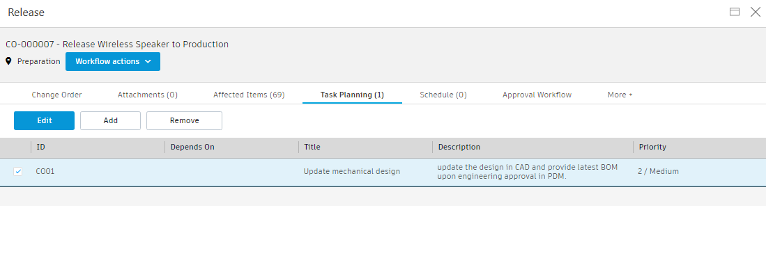

      Note: At this point, if you chose a change template that contains tasks that were copied into this CO, you must remove them before you can submit the CO for review. Locate tasks in the Task Planning tab, select each one, then click Remove.
      remove tasks

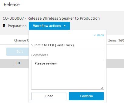

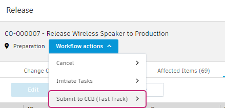

  6. Send the CO for review by the change control board (CCB).
    1. Open the Approval Workflow tab and note the change order workflow.
    2. Click the Submit to CCB (Fast Track) transition. Alternatively, from the Workflow Actions drop-down menu, select Submit to CCB (Fast Track).
      submit to CCB workflow action
    3. Optionally enter a comment, then click Submit.
      enter comment and confirm
      The CO is now at the Change Control Board Review state.
