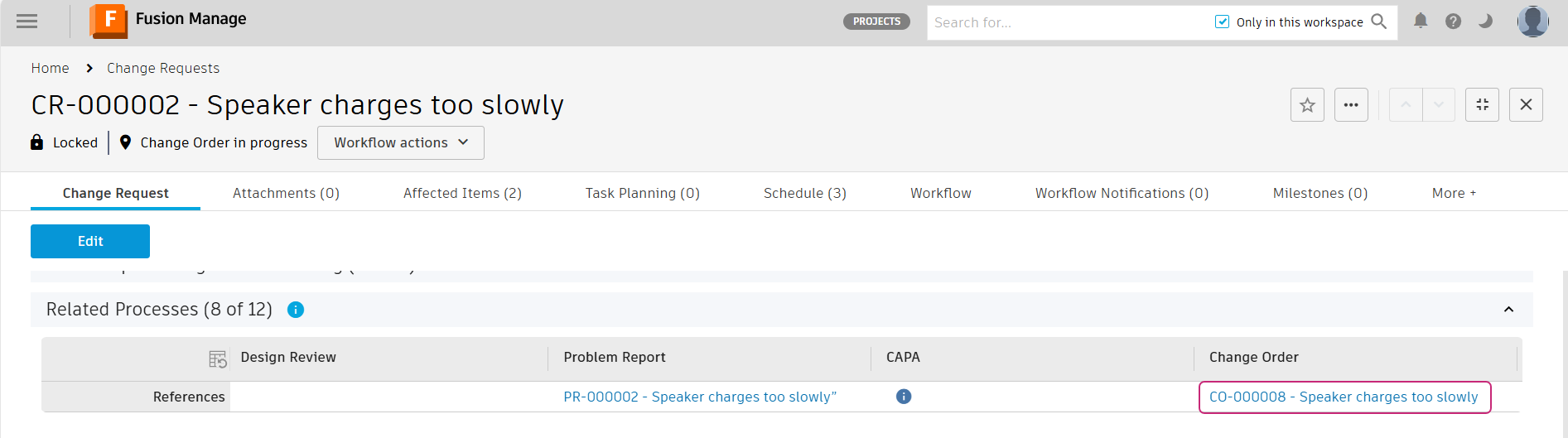

  2. In Tutorial 7, you generated a change order automatically from a change request. Navigate to that change order.
    1. Open the change request.
    2. Expand the Related Processes section.
    3. Click the Change Order link.
      related processes change order link

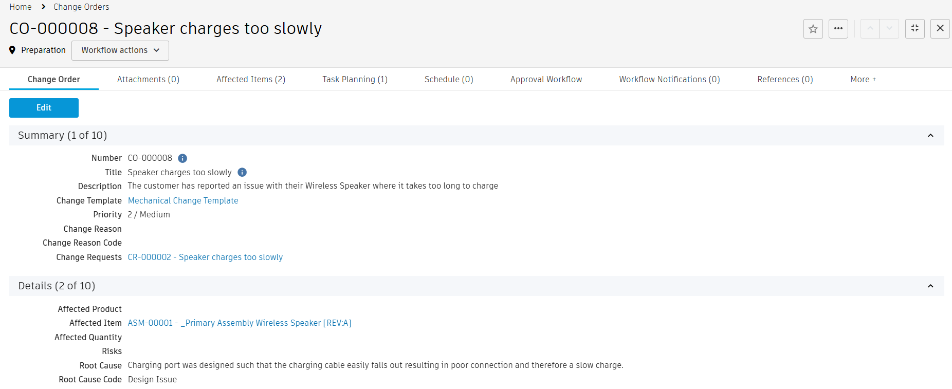

  3. Notice the information that has been carried forward from the change request, and the preceding problem report.
    • The Summary and Details section of the change order is populated with information from the related problem report and change request.
      summary and details from problem report and change request

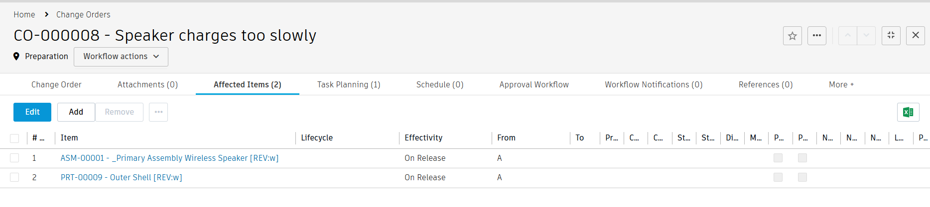

    • The Affected Items tab of the change order show the Outer Shell and Wireless Speaker items that were copied from the change request.
      affected items copied from change request

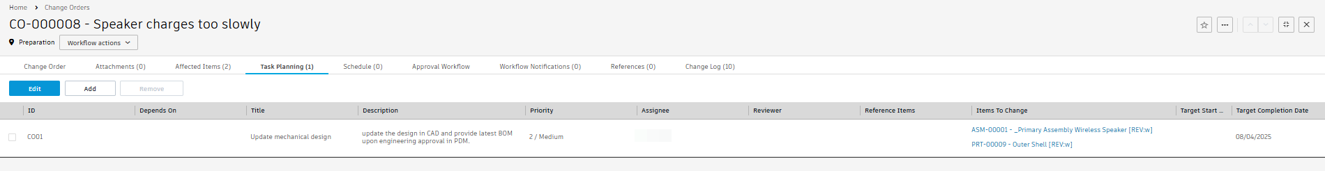

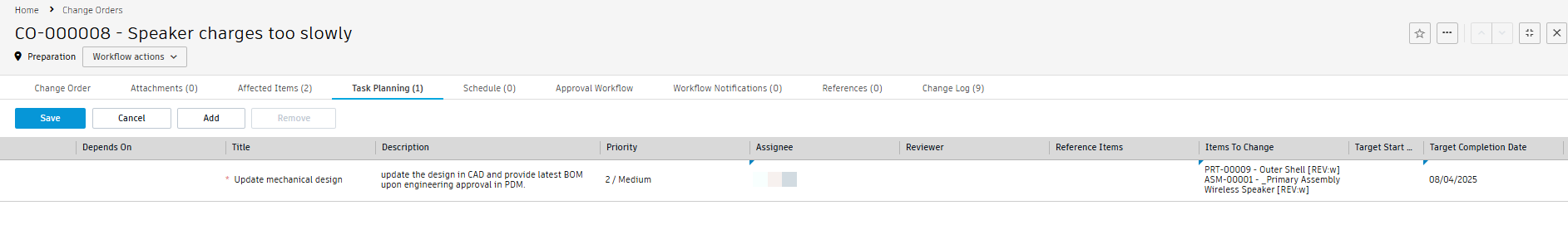

  5. The Task Planning tab can be used to define the list of activities to be completed before the change order is submitted to the change control board for review. Once tasks are specified in this tab, you cannot send the CR for CCB review until all tasks are complete. In Tuturial 4, you didn't do this and were able to fast track it directly to CCB review. Since you chose a change template in the problem report, tasks from there have been copied into this change order. Assign the tasks to yourself and set a target completion date for each task. A task has already been added from the change template to the Task Planning tab to carry out the design change. Assign the task to yourself, add components to change, and set a target completion date for it.
    1. In the Task Planning tab, click Edit.
    2. In the Assignee column, click to add your name to each task.
    3. In the Target Completion Date column, click to set the date one week from now for both tasks.
    4. In the Components to Change column, add the Outer Shell and the parent Wireless Speaker assembly items. This is because a change to a component will affect its parent assembly as well.
      add assignee target completion date items to change
    5. Click Save.
      after saving task planning tab

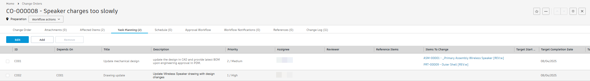

  6. Add a second task to update the drawing.
    1. Click Add.
    2. Enter the following details. Required fields are marked with a red asterisk.
      • ID: CO02
      • Title: Drawing update
      • Description: Update Wireless Speaker drawing with design changes
      • Priority: High
      • Depends on: CO01
      • Assignee: Yourself
      • Components to Change: Wireless Speaker drawing
      • Target Completion Date: one week from now.
        add second task
        Note: You cannot select items from the Drawings workspace here, but you will be able to add the drawing to the task, which will copy it to the Affected Items tab on this CO.
    3. Click Save.

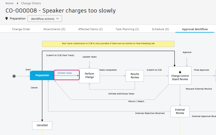

  7. Initiate the tasks.
    • Option 1: From the Workflow tab, click Initiate Tasks transition.
    • Option 2: From the Workflow Actions drop-down, select Initiate Tasks.
      initiate tasks workflow action
      The workflow moves to the Perform Change state and change tasks are created for the two activities added in the Task Planning tab. These change tasks are placed in the Change Tasks workspace and receive a number in the format <CT>-<CR number>-<ID>-<Title>.
      At the far right of the Task Planning tab of the change order, the Task column shows link to these tasks. Observe that these tasks are added to the Schedule tab according to their Target Start and Completion dates. Since you assigned them to yourself, you'll find these tasks in your My Outstanding Work list.
      The first task CT-<CO number>-CO01-Update mechanical design is automatically put into the Assigned state. The second task CT-<CO number>-CO02-Drawing update is put into the Planned state because it depends on the first task being complete first.
