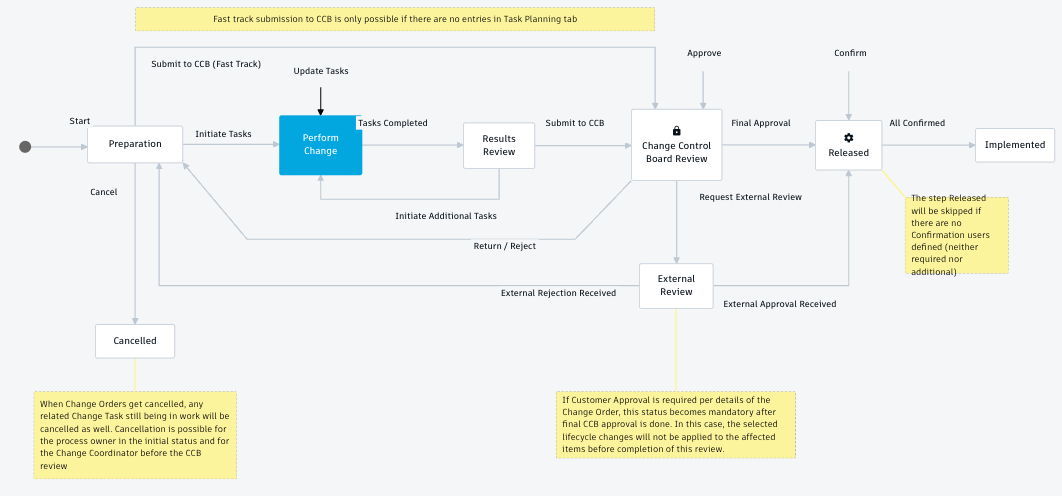

Lifecycles and workflows combine to form the basis of process management.
A workflow refers to the actions required to complete a managed process such as creating, reviewing, and approving change orders or analyzing problem reports. A workflow consists of states and actions.
change order workflow
Workflow states
A state is a stop along the workflow path. States are represented as boxes on the workflow map. All change management processes are in a workflow state at any given time. The current state is highlighted blue on the workflow map.
Actions
A workflow action is the path connecting one state to another and represents the action required to enter a state. Workflow actions are represented as arrows on the map. A state may have one or more possible actions for you to perform. The available actions are based on the current state and your workflow permissions. Available actions are indicated as bold paths leaving the current state. When an item reaches a new workflow state, one or more actions may become available depending on the workflow.

Lifecycle management
While workflows track the progress of change orders, change requests, problem reports or change tasks, lifecycle states track the revisions of designs and drawings.
Revising items and moving them through the product lifecycle is accomplished using change management processes. When a design or a drawing item is attached to a change order, the item can be revised. As a change order progresses through the approval workflow, the items attached to the change order progress through the product lifecycle states.
