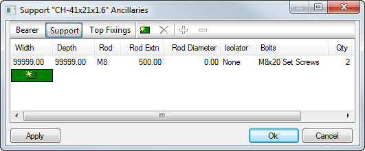

Example 1 - Additional Quantity of Fixings

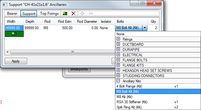

Bolt assignment can be grouped as a set quantity as shown below or can be broken down into individual ancillaries and then made into an Ancillary Kit. This Slotted Channel support setup shows M8x20 Bolts being assigned as a single ancillary. The terminology used on the description of the ancillary in this case, is to say that there is a set included. However, with the use of a Ancillary Kit, we are able to build up the makings of the set and then use these for reporting exact quantities on the project. I.e. for each Nut, Bolt and Washer quantity totals.

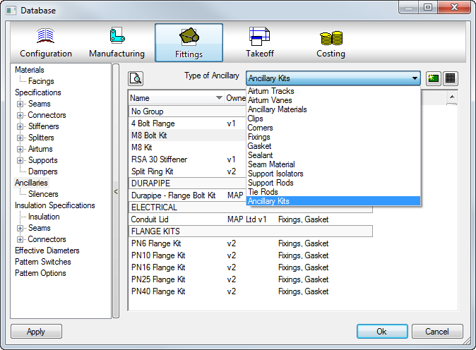

Fittings From the left menu, select Ancillaries . You can use the Type of Ancillary drop down menu to then access Ancillary Kits.
All Ancillary Kits created in the database are listed here. There is the option to create a new Kit or select an existing kit by highlighting the row and then selecting new to create a copy of the existing one present in the database.

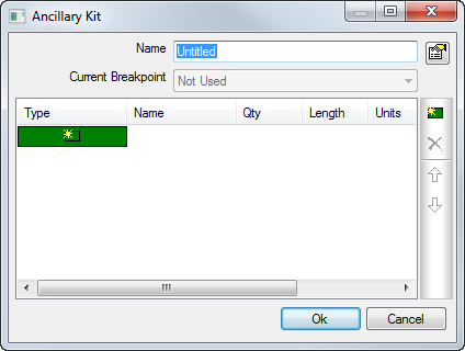

Providing an overall name of the Kit and then adding for each ancillary, a row for each type required as shown above. On selection of Type, the Name then has a drop down of the database selection of each ancillary listed. Here we have added 3 rows as Fixing types, so the Name field becomes a drop down option of all Fixing ancillaries in the database (requirement to be created prior to selection).
Providing each row with a quantity or length means that when the Kit is used, the quantities entered here will be taken off each time. The Ancillary kit, once saved, can then be applied to the required Connector, Support or Stiffener etc. If using the length field, ensure the ancillary used has a cost per meter.

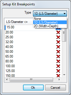

On creation of the new Ancillary Kit, selecting the Properties option allows entry of a breakpoint list.
The Breakpoint type can be a Width / Depth table or just a LS/Diameter based table.
Adding multiple breakpoints which cover the sizes of pipe used at takeoff will allow to filter the breakpoint for selection of ancillary used for that size. From selecting the Current Breakpoint, you are able to choose which breakpoint is to be customized.

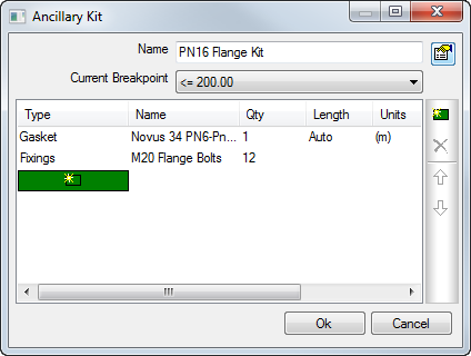

The example below shows selection of 200 dia where we can now setup the Ancillary Type and use the Name drop down to choose the pre-existing ancillary.
The Gasket type would be a length based item (costed per meter), which enables the Length to be set at Auto. The Auto Length would calculate the circumference automatically from the pipe is use. As this Kit will be allocated against one of the Connector ends, the software will use the Connectors circumference on the pipe to determine which breakpoint selection of ancillaries is to be used at takeoff. This applies the quantity and costs to the connector and therefore includes these into the Items rate.
Cycling through each breakpoint and assigning the relevant ancillaries and their quantities then completes the Ancillary Kit setup.

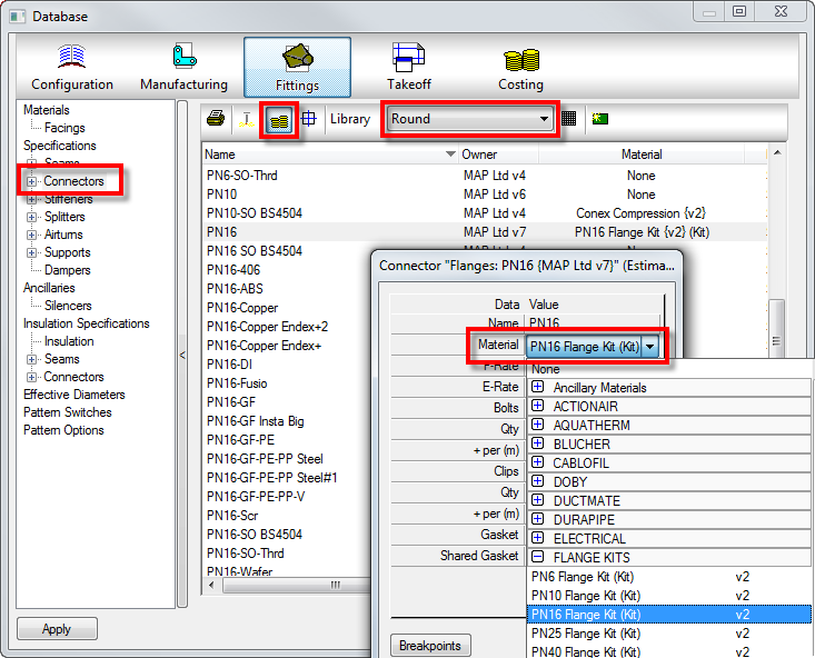

Assigning the Ancillary Kit to the Connector
From the Connector Database (Database Fittings Connectors), accessing the Costing icon for Round Connectors , allows assignment of Ancillary kit to the material section. Double clicking the Connector opens up the dialogue for assigning the newly created kit. The Material section calculates the periphery or circumference of the connector. The Auto length from the Gasket assignment in the Kit, will populate this length and report the correct amount Gasket required.

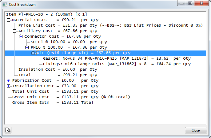

The Cost breakdown of the 100 dia PN16 flange is shown below. As this only has one connector called PN16, this will report the Ancillary Kit assigned as a quantity but within the kit lies the Gasket and Bolts with their own quantity values.

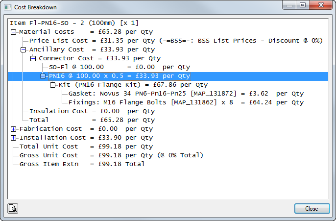

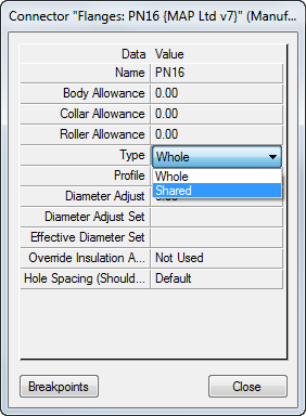

The connector PN16 from the database can be additionally setup to be Shared from the setup which will half all values assigned if using for sharing of joints.
Now when viewing the breakdown, the cost of the Kit is halved (multiplied by 0.5) at the end calculation which is used when sharing joint quantities.
