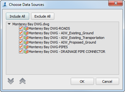

    The Choose Data Sources panels appears and lists which data can be brought in as InfraWorks 360 model objects. (InfraWorks 360 will perform a conversion on AutoCAD Civil 3D drawing objects when you bring AutoCAD Civil 3D data into InfraWorks 360.) By default, the data you bring in from AutoCAD Civil 3D is sorted by Feature class, unless you chose to sort by Source Type in the Data Sources panel.
  3. Choose the data source types to bring into the model at this time and click OK.

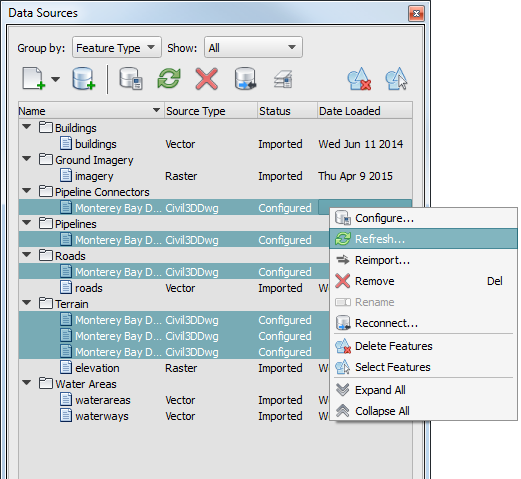

  4. Refresh the selected data sources from the right-click menu or click .
  5. Click OK.
  6. InfraWorks 360 displays the added data as InfraWorks 360 features.
