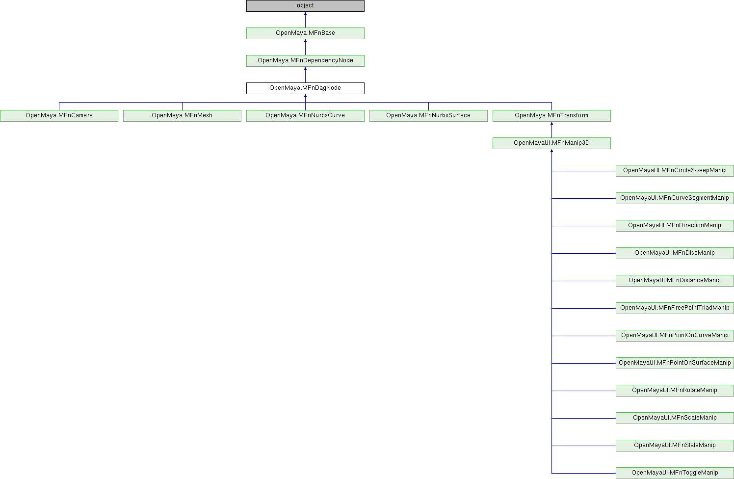

Method resolution order:
- MFnDagNode
- MFnDependencyNode
- MFnBase
- __builtin__.object
Base Class
MFnDependencyNode
