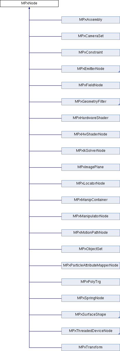

C++ API Reference
Base class for user defined dependency nodes. More...
#include <MPxNode.h>
+ Inheritance diagram for MPxNode:
