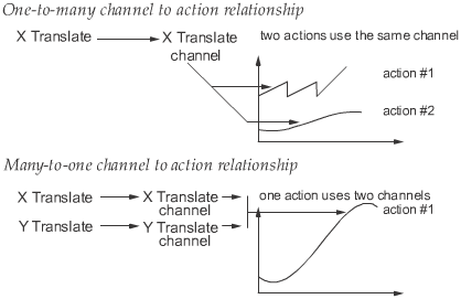

Usually a channel is not animated by a single motion path action, but also has a parameter curve action to specify the animation’s timing along the motion path action (Animation > Tools > Set Motion; see Create a motion path animation). In this case, there is no longer a simple relationship of one channel to one action. The channel uses two actions to determine what values to tell its animation parameter to assume.
In both these cases, the channel is animated by a base action, and each additional action applied to the channel is called a time warp. This ability for a channel to use many actions is called a one-to-many relationship, because one channel uses many actions to determine what values its animation parameter should assume.
What is a many-to-one relationship?
Having many channels use the same action is a many-to-one relationship. Since there is both a one-to-many (for example, one channel using several actions) and a many-to-one (for example, several channels using one action) relationship between channels and actions, the combined relationship is actually many-to-many. That is, any number of actions can be associated with any number of channels. The many-to-many relationship between channels and actions provides a greater degree of flexibility in creating your animations.
If a channel uses more than one action, then the channel has an expand channel button next to its name in the Action Window. If you press this button, you see the list of actions that a channel uses.
To see which channels use an action, you can select the action and choose Curve Tools > Show instance in the Action Window.
