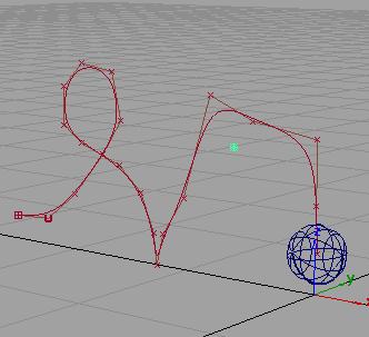

A keyframe represents an object's position at a certain time. You can animate an object by setting a few keyframes at certain points. Alias can then fill in the object's motion between each pair of keyframes.

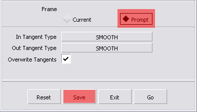

  1. Choose Animation > Keyframe > Set Keyframe to open the Set Keyframe Options box.
    The Set Keyframe Options box is opened.
  2. In the Frame section, click Prompt, so that the system will prompt you to enter the keyframe time when you set a keyframe.
    Then, click the Save button.
    The Set Keyframe Options box closes.
  3. Choose Pick > Object and click the object in your model you wish to animate.
  4. Choose Transform > Move.
  5. Drag the mouse to a new location you want your object to move to.
    The object you have chosen is now in a new location.
  6. Choose Animation > Keyframe > Set Keyframe to create a keyframe for the object at its current position.
  7. Then type 0 and press Enter to set the point-in-time for the keyframe to frame zero. This will be the start point of the animation.
  8. With the Move tool still active, turn on magnet snap mode again.
  9. Drag the mouse to final position to move the object there, then turn off magnet snap mode.
    Your object is now snapped to final position in the animation.
  10. Choose Animation > Keyframe > Set Keyframe to create a keyframe for the object at its current position.
  11. Type the end time for your animation and press Enter to set the point-in-time for the keyframe.

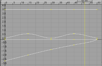

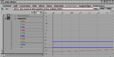

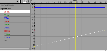

Edit the animation curve tangents
There will be a number of times when you want to edit your animation to make it more realistic. To show you how this is done we provide an example of editing a sphere in an animation.
First you'll change the sphere's rate of speed at the beginning of the animation by editing its animation curve tangents.

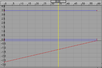

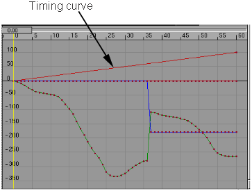

  1. With the sphere still selected, choose Animation > Editors > Action Window to open the Action Window.
    The Action Window displays the animation of selected objects using line graphs called animation curves. Each animation curve represents one of the object's parameters. An animated parameter is referred to as a channel.
    The horizontal axis represents time and the vertical axis represents the parameter's value. Each keyframe is indicated by a small red dot.
    The parameter names are listed along the left side of the window.
  2. Choose the Look At command (Views > Look At) in the Action Window to better view all of the animation curves.
    The complete animation curves are displayed.
  3. Click each of the parameter names to select and highlight its corresponding curve.
    You will note that all of the animation curves are horizontal except for one diagonal line.

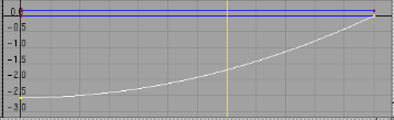

  4. Click the first parameter name (X Tra) to select it.
    This is the X translation parameter. It represents the movement of the object in the X direction.
    The parameter and the diagonal line are highlighted.
    The X Translation line is the only non-horizontal line because the sphere is animated only in the X-axis direction. The curve is a straight line because the sphere moves at a constant rate of speed.
  5. Choose TangentType > Slow seg out to change the tangent of the curve at each keyframe. This changes the sphere's rate of speed at the beginning of the animation.
    The diagonal line becomes curved, so the sphere will begin moving very slowly and gradually increase its speed.

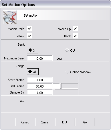

Create different segments of your animation
How to use Animation > Tools > Set Motion to create several different segments of an animation.
For example, you can do the following:

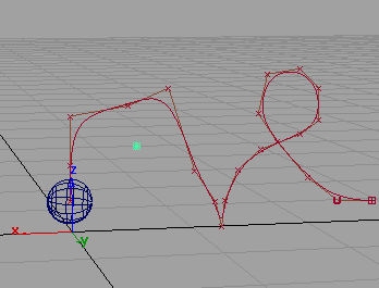

How to edit animation curves and smooth out the motion or apply abrupt changes at each point in your animation to emphase the movement of your model.

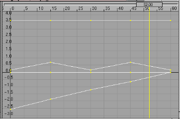

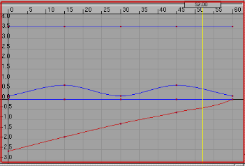

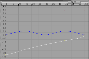

  1. With the sphere still selected, choose Animation > Editors > Action Window.
    There is now a second curve that is not horizontal. This wavy curve represents the sphere's translation in the Z-axis direction.
  2. In the Action Window, choose Pick > Nothing to deselect all curves.
  3. In the Action Window, choose Pick > Keyframes
  4. Drag a pick box around all keyframes to select them.
    Selected keyframes are highlighted in yellow.
  5. Choose Tangent Type > Linear seg in to change the tangent of each curve at each keyframe.
    The smooth curves are now jagged lines. This will make the object's motion abruptly change at each point.
  6. Click the top left corner of the Action Window to close it.

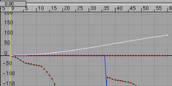

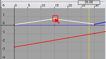

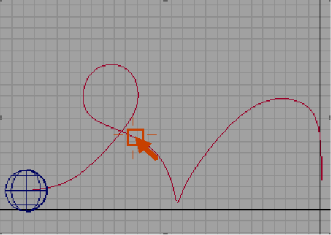

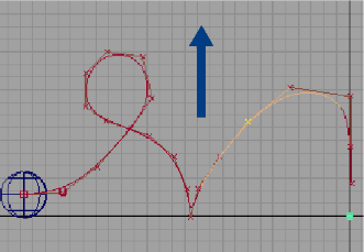

Move keyframes on an animation curve
How to move keyframes on the animation curve.
To move keyframes

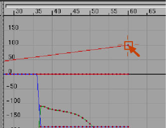

  1. Pick the object your wish to animate then choose Animation > Editors > Action Window.
  2. Pick nothing in the Action Window to deselect all curves.
  3. Choose Pick > Keyframes from the Action Window menu.
  4. Click the second keyframe of the Z Translate curve to select it.
    Tip:
    To get a better view of the action curves, you will have to move the camera in the Action Window. You can use the camera hotkeys: hold down the and (Windows) or (Mac) keys, and drag the to track, the to dolly.
  5. Choose Transform > Move in the Action Window.
  6. Drag the up to move the keyframe from its current position.
  7. Close the Action Window.

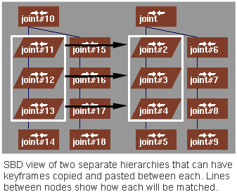

Copy keyframes
How to copy animation channels for other animations.
Use Animation > Keyframe > Copy Keyframe to copy a range of keyframes from an animated object, and place them on the keyframe clipboard for pasting somewhere else.
When you are working with animated sequences, it is often necessary to copy a sequence from one object to another, or to repeat a sequence. Copy keyframes and Paste keyframes provide a simple way to do this.
Copy keyframes lets you select an object and specify a range of keyframes from the object’s animations to copy. The selected keyframes are then copied to a keyframe clipboard, which lets you mirror or paste the keyframes onto another object (or even back onto itself).
To copy keyframes into your animation
  1. Pick an animated object and choose Animation > Keyframe > Copy Keyframe.
    Note:
    This operation overwrites any other keyframes that may already have been placed on the keyframe clipboard.
    The system prompts:
    Enter the frame range to copy (start, end):
  2. To copy the animation between frame 30 and 60, for example, type:
    30 60
    Tip:
    To copy a single frame, type the same frame number for both the start and end frame.
  3. Choose Animation > Keyframe > Paste Keyframe.
What if...?
I want to paste the animation somewhere else.
See Paste keyframes for more information.

  1. Pick an animated object and choose Animation > Keyframe > Cut Keyframe or Copy.
    See Cut keyframes and Copy keyframes.
  2. Pick another object (or the same object) and choose Animation > Keyframe > Paste Keyframe.
    Tip:
    You can copy a range of keyframes from one hierarchical object to another, even if the two objects do not share the exact same topology. The ordering of nodes in the SBD window is used to match up nodes from the source object with those of the destination object(s). Only nodes that have the same relative SBD position and node type are matched.

To create a motion path animation

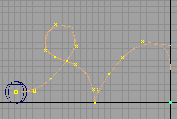

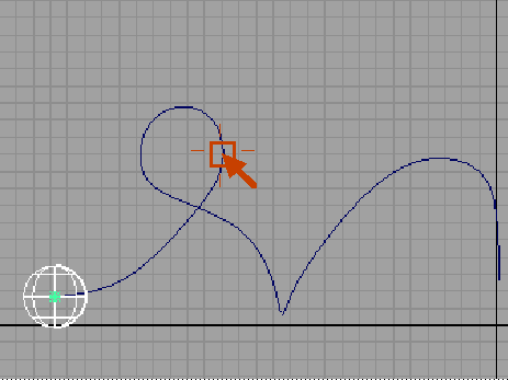

  1. Choose Curves > New Curves > New CV Curve. Draw a curve to be used as your motion path.
  2. Choose Layers > New and name it MyMotionpath.
  3. Make the MyMotionpath layer visible.
    This layer should contain the object you want to animate and the curve you want to use as the motionpath.
  4. Choose Pick > Object and click the object you wish to animate.
  5. From the Animation menu, choose the box beside the Set Motion tool (Animation > Tools > Set Motion ) to open the Set Motions Option box.
    The Set Motion Options box is opened.
  6. Set the Start Frame field to 0 to set the beginning of the animation to frame 0. Set the End Frame field to 60 to set the end of the animation to frame 60. Then, click the Go button. (Note, these number are only used for an example. You may apply any range.)
  7. Click the motionpath curve to animate the object along the curve.

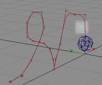

Set up a camera to travel along a motion path
Allows you to animate the camera view of a scene along a path to effectively simulate a walkthrough of a scene.
  1. Choose Animation > Tools > Autofly (If you want to specify options such as start and end frames, choose Autofly)
    The following prompt is displayed:
    Select the motion path for the camera EYE to follow
    Note:
    Objects do not have to be active when this function is invoked.
  2. Click the curve you want to assign as the motion path for the camera eye. The curve will change color to indicate that it is now a motion path.
    Once the camera eye motion path has been selected, the system prompts:
    Select the motion path for the VIEW, or select the GO icon
  3. To use a second curve for the camera view, click the curve that you want to assign as the motion path of the camera view.
    If you click the Go icon instead, the system uses a camera view motion path that is straight ahead along the motion path chosen for the camera eye.
  4. Once you select the camera view motion path and clicked the Go icon, the system prompts:
    Select the motion path for the UP, or select the GO icon
    To use a third curve for the camera up, click directly on the curve you want to assign as the camera up path.
    If you click the Go icon instead, the system generates the camera up motion path. The camera is oriented in the up direction, and banks around curves according to the current Maximum Bank degree values set in the Autofly Options box.
  5. When you are finished selecting curves, a new perspective window is created and its camera is animated along the curves.
  2. Choose the Look At command (Views > Look At) to better view all animation curves.
    When you animate an object along a motion path, Alias creates a keyframe at each frame of the animation. (Remember, a keyframe is indicated by a red dot.)
    There is one diagonal line that has only two keyframes. This is known as the timing curve, and it represents the constant speed of the object along the curve.
    To edit an animation along a motion path curve, you usually edit the motion path curve (in the view window) or the timing curve. You don't usually edit the animation curves because they are so complex.
  3. Choose the Pick Keyframes command (Pick > Keyframes).
  4. Click the last keyframe of the timing curve to select it.
  5. Choose the Fast Segment In command (Tangent Type > Fast Seg In) to change the tangent of the timing curve at the selected keyframe.
    The diagonal timing line is now curved. This will make the object begin moving very slowly and gradually increase its speed.
  6. Click the top right corner of the Action Window to close it.

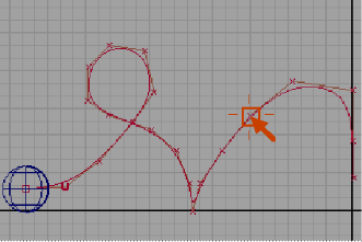

I want to edit the motion path

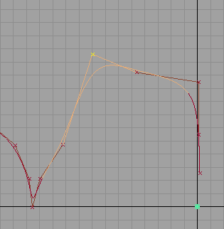

  1. Choose Pick > Nothing to deselect all objects
  2. Choose Pick > Object and click the motion path curve to select it.
  3. Select the box beside the Control command (ObjectDisplay > Control ) to open the Object Display Control window.
  4. Set Scope to Active and make sure that only the Hulls and CVs options are on, then click Go.
  5. Click Exit to close the Object Display Control window.
    The hulls and the CVs of the motion path curve become visible.
  6. Pick nothing to deselect all objects.
  7. Choose Pick > Point Types > CV and click one of the motion path curve's CVs to select it.
  8. Choose Transform > Move and drag the up to move the CV up.
    The CV is moved up and the shape of the motion path curve is changed.

To edit a motion path
  1. With the object still selected, choose Animation > Editors > Action Window.
