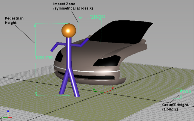

The output is a degree 1 curve (polyline) that lies on the hood and indicates where the top of the head of a pedestrian of the given height would impact the selected surfaces if the pedestrian was hit by the car and fell across the hood. The number of spans corresponds to the value of Impact Curve Samples in the control window.

We assume that the Z axis is the vertical axis and that the centerline of the car is along the X axis (see illustration above).

Ground Height
Ground plane location (height along the Z axis in current units). The default is Z = 0.
Impact Zone (+/-)
Distance from the centerline (along the Y axis) that defines the impact zone. This will be the extent covered by the output curve. The default is +/- 600 mm.
Pedestrian Height
Height of the pedestrian in current units. The default is 1250 mm.
