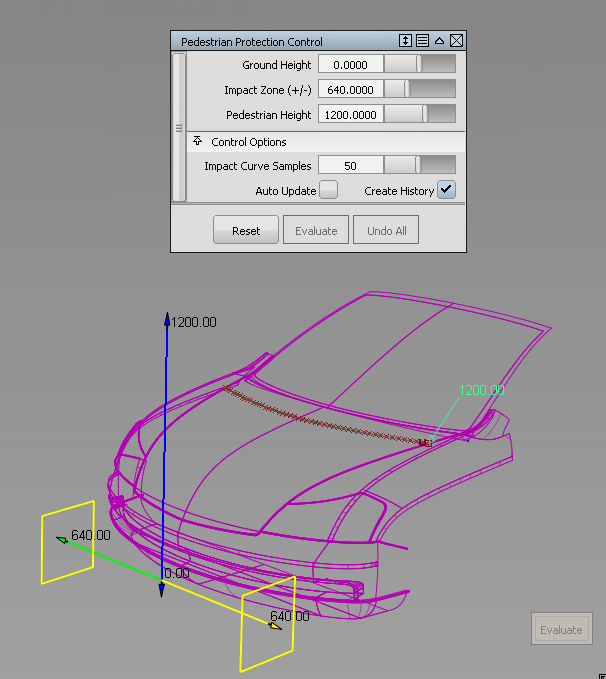

  1. Choose Evaluate > Pedestrian Protection .
  2. Select the surfaces that define the front of the vehicle.
    The surfaces turn purple.
    A manipulator appears 100 mm in front of the selected surfaces.
    Note:
    Surfaces that were already picked prior to accessing the tool are included in the selection.
  3. Adjust the parameters (Pedestrian Height, Impact Zone and Ground Height) through the control window or by dragging one of the manipulator arrowheads.
    Note:
    The manipulators move in 10-unit increments. You can also enter a more precise value through the keyboard.
  4. Click the Evaluate button (either in the control window or at the bottom of the active view window) or press the space bar.
    The impact curve is calculated and drawn. An annotation is attached to the curve showing the corresponding pedestrian height.

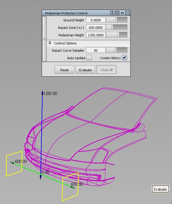

  5. Modify the Pedestrian Height, Impact Zone or Ground Height through the control window, or by dragging one of the manipulator arrowheads.
  6. Add or remove surfaces from the selection by clicking on them.
    Note:
    In the default configuration, the toggles the selection.
  7. Click the Evaluate button again.
    The impact curve and its annotation update.
