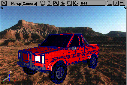

An image plane is an image that you can attach to a camera’s view. This image appears in the camera’s modeling window and in images rendered from that camera (either in front of or behind the scene). Any camera can have one or several image planes. For example, you could use an image plane as a visual reference when building a model or as a background for your scene when rendering.

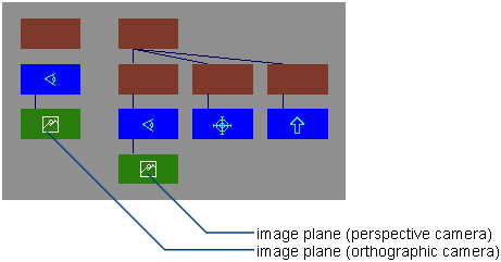

An image plane appears in the SBD window beneath the camera’s eye node. This it is not a hierarchical grouping, however. Any transformations you make above the eye node do not affect the image plane. If you add an image plane to an orthographic camera, the orthographic camera appears in the SBD window with the image plane beneath its eye node.
