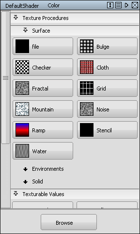

The Texture Procedures window contains a list of all textures (Surface, Environments, and Solid) and a list of all Texturable Values for the active environment/shader/texture/light.
