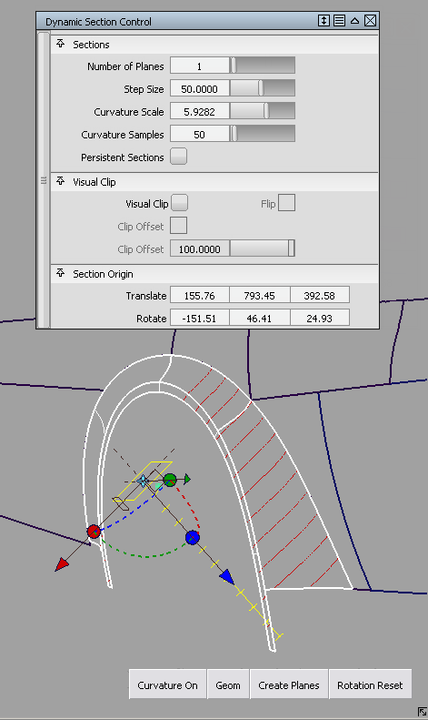

Lets you move a plane through a surface or mesh to show cross sections dynamically.
- Pick the surfaces or meshes you want to examine.
- Choose Evaluate > Dynamic Section
. A sectioning plane appears, at the geometric center of the object(s). A red cross section appears on the selected objects where the plane intersects them.
Note:
At any time you can click additional surfaces or meshes to add to the selection. Clicking an already selected surface or mesh removes it from the selection. (You can use a pick box instead of clicking.)

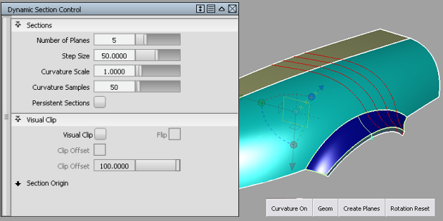

- Set the Number of Planes (number of sections) and Step Size (spacing between sections) in the option box.
The cross sections appear as red lines and update on the objects.

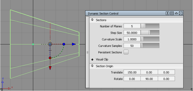

- Use the manipulator to orient the sectioning plane, or enter specific values in the Translate and Rotate fields in the control window.
Changing these values update the plane manipulator, and vice-versa.
The cross sections update as the plane is moved/rotated.
Note:
Using the Translate fields lets you cut a section at a specific location along one of the main world axes (for example X = 100).

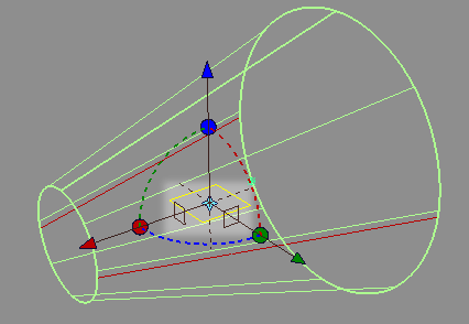

- Use the manipulator to move the sectioning plane through the surfaces.
- Select an existing construction plane to use as the base sectioning plane.
- Click the Geom button to create free curves from the cross section(s).
- Click the Create Planes button to create construction planes corresponding to the sectioning planes.
- Click the Curvature On button to show a curvature comb plot on the section(s). To change the scale of the comb plot, adjust the Curvature Scale setting.
- Click the Rotation Reset button to reset all the rotations on the sectioning plane to 0, and re-align the sections with the X, Y, and Z axes.

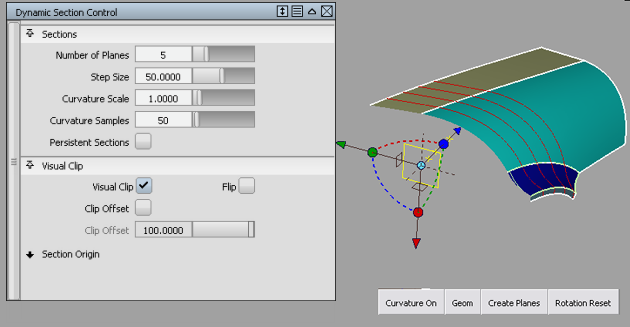

- Turn on Visual Clip in the control window, to see only the part of the model in front of the sectioning plane. Turn on Flip to see only the part of the model behind the sectioning plane.

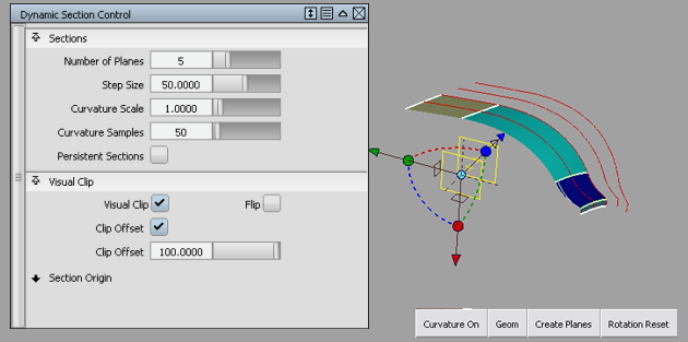

- Turn on Visual Clip and Clip Offset to create an additional plane parallel to the sectioning plane, and see only the part of the model between the two planes.
- Turn on Persistent Sections in the option box for the sections to remain visible after exiting the tool.

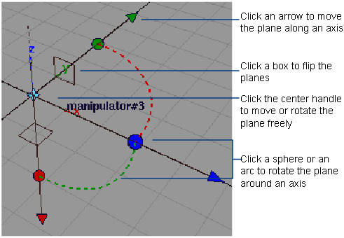

How do I use the manipulators?
Note:
The manipulators are visible through shaded geometry.
Sectioning Plane
- Drag a handle to move/rotate.
- Click an arrow to change the center handle to the free move handle. Then drag the center handle to move the plane freely.
- Click a sphere or arc to change the center handle to the free rotate handle. Then drag the center handle to rotate the plane freely.
- Click a box (square) to set the plane perpendicular to one of the manipulator axes.
Clip Offset Plane
- Click the plane or the arrow (they turn white) and drag to change the offset distance.
Note:
When the sectioning plane is moved or rotated, the offset plane is moved or rotated along with it, so that both planes always remain parallel and separated by the same distance.
Define two visual clipping planes
You can define a secondary visual clipping plane parallel to, and at a given distance from, the primary clipping plane. Only the part of the model between the two clipping planes is displayed.
This secondary plane is always driven by the location and direction of the primary plane.
- Select surfaces or meshes
to open the option window.
- Adjust position and orientation of the sectioning plane.
- Turn on the Visual Clip option.
The display of surfaces/meshes is clipped to the location and direction of the current plane.

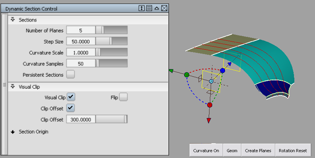

- Turn on the Clip Offset option.
An offset plane appears, and the display of surfaces/meshes is clipped to the location and direction of that second plane as well, leaving only the part of the model between the two planes visible.
- Use the Clip Offset slider, or click and drag the offset plane manipulator, to adjust the offset distance of the second clipping plane from the first.
The clipped area updates.
Both the slider value in the option window and the offset plane manipulator on the model update to reflect each other.

Cut a section at a specific location along one of the main axes
- Choose the orientation of the sectioning plane by clicking on one of the three square icons on the manipulator.
- Enter the X, Y, or Z location of the plane in the appropriate Translate field.
A discreet section cut at x = 150.0
