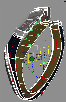

Evaluate > Dynamic Section
Lets you view a cross section of surfaces or meshes by dragging a plane through the model.
This tool produces cross-sections in an arbitrary orientation by using a series of parallel planes with a distance between them specified by Step Size.
Unlike the Planar cross sections available from Windows > Editors > Cross Section Editor, dynamic sections update interactively on the geometry as you transform the reference plane.
Procedures
Drag dynamic cross sections through surfaces
Create or view cross sections

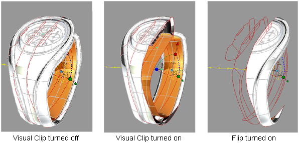

Visual Clip
These options let you visually clip the wireframe and shaded model, leaving the sections visible.
Visual Clip
Check this option to display only the part of the model with the sections (on one side of the sectioning plane).
Flip
Check this option to display only the part of the model that does not have sections. The sections on the invisible part are still displayed.
Clip Offset
This option is only available if Visual Clip is turned on.
When checked on, a second clipping plane appears, and the display of surfaces/meshes is clipped to the location and direction of that second plane as well, leaving only the part of the model between the two planes visible.
The Clip Offset slider specifies the offset distance of the second clipping plane from the first.
